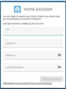

Step 4: Run and Configure the Home Assistant
http://your.ip.address.here:8123/
If everything is successful, you should see the following screen:
NOTE: Since there are always changes and updates to get up-to-date information, please refer to https://community.home-assistant.io/t/installing-home-assistantsupervised-on-debian-11/200253
