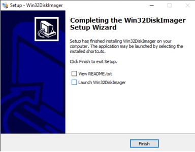

Step 6: Completing Win32 Disk Imager
As it’s a light program the installation will be done quickly as such the end screen will pop up and asks if you’d like to run the program directly. Now we will not run the program as we need the OS file also to be downloaded.
