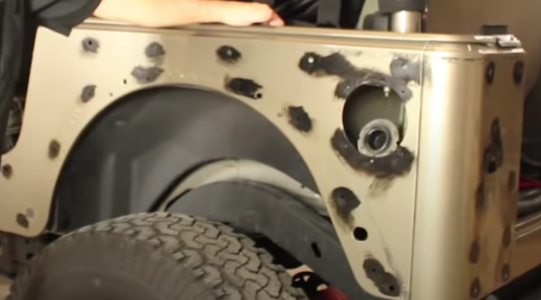

Step 6: Drill Time
Note: Check the instruction booklet for drill bit sizes, they vary heavily per kit!
Grab your center punch and punch a divot where you marked, this will ensure that your drill stays in place. Once you punch all the holes, look behind where you are drilling to make sure there are no wires, carpet, or anything that you might hit when drilling through. One place of note is the hole you might have to drill near the seat belt, be very careful of that. Once you have cleared anything in the way, grab the drill bit recommended for your top holes and begin to carefully drill into the body. Do that for each hole, going slowly to make sure you don’t damage anything. For the lower holes, check to see if the hardware provided will fit in the preinstalled holes. If not, use something like a ¼” drill bit to bore out the hole a little.
Photos provided by Morris 4x4 Center on YouTube from this video (except the seatbelt).
Step 7: Paint or Rust
If you do this step with the armor still mounted on clamps, be careful to not get paint on the outside of the armor. Using rust prevention paint that is safe for cars/metal, paint the inside edges of every hole you drilled. Doing this prevents rust and further damage. It is possible to use a paint touch up marker, but I would be careful unless it specifically says that it will prevent rust. Once done, wait for the paint to dry, thought it shouldn't take very long.

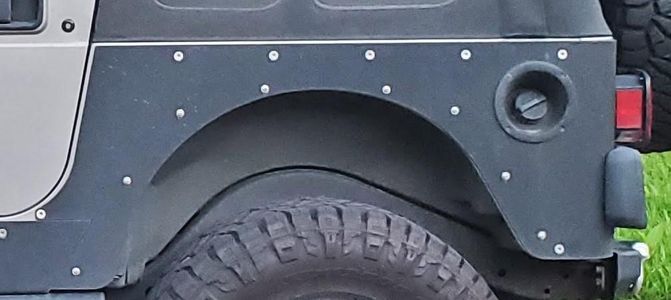

Step 10: The Final Touches
If your license plate holder and gas cover are faded or grey looking and you would like to make them look like new again, do this before you reinstall them (works for the old fender flares as well). Take the cover and license plate holder and place them on a table. Take your heat gun or hair dryer and hold them about a foot away from the parts. Keep sweeping the heat gun over the pieces at a somewhat slow pace, making sure you are very careful not to melt the plastic, till they become black again. Do this to all sides of the pieces. If you see that the plastic has not changed color after a short while, move slightly closer to the plastic, you should never get closer than about 6-8 inches from the plastic though, too close and you will damage them. Once done, reinstall the gas cover and license plate holder.
Step 11: What to Do When You’re Done
When everything is reinstalled and working, take a drive around your neighborhood. Part of this is to show off your new install, but it is mostly so you can see if anything is wrong. Ride around with no music or loud noises for a while and listen for any strange noises. Noises such as rattling, clanging, or banging could be signs that something is not installed correctly. Find a place to stop and check on what might be the issue. If driving on a flat road seems fine, find somewhere with a few speed bumps. Go over them at various safe speeds to make sure your armor won’t just be shaken off when on the trails. Once everything sounds good, you're all done, congratulations on installing your rear corner armor, have fun!
