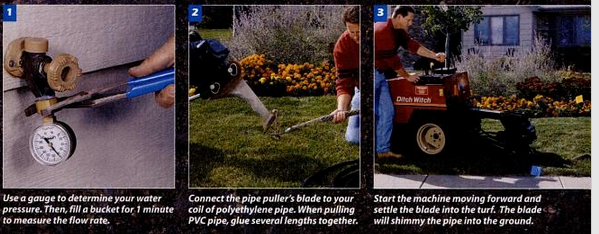

If you plan to dig the entire system by hand, dig the main runs first, then the branch lines. They should be at least 6 in. deep, but 8 to 10 in. will give you better fitting room.If you’ve rented a pipe puller, begin by attaching the pipe to the
machine’s blade (Photo 2). When running a main feed line, it’s best to wrap the low-voltage cable around the pipe and pull it at the same time. With the piping connected, start the machine moving forward and lower the blade into the ground (Photo 3).

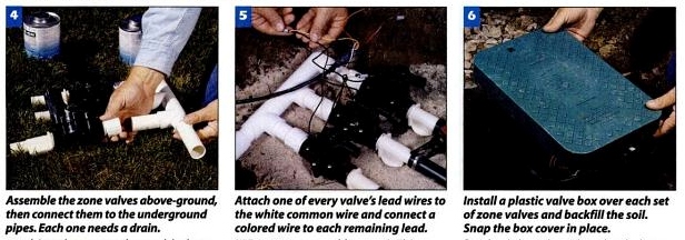

Bore through your home’s rim joist and run copper pipe and cable through the hole and to the ground. Make the conversion from copper to PVC at ground level with a threaded connector. Run the main PVC line, along with the cable, to the first zone-valve location. Assemble the valve sets above-ground, then cement them to the underground piping (Photo 4). Install a plastic, inline drain fitting on the downstream side of each valve and connect the cable wires.
Our cable had 10 wires and each zone valve had two lead wires. Connect one of each pair of valve lead wires to a common (white) cable wire that will service all of the valves. Join a different color-coded wire to the other lead of each zone valve. Continue making connections in this way until you’ve reached the last set (Photo 5). With all the valves connected and wired, install valve boxes and backfill (Photo 6). The feed line also needs to have a drain fitting at its lowest point.

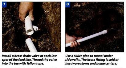

Thread a brass drain fitting into the threaded branch of a PVC tee and install the tee at a downward 45˚ angle (Photo 7). Dig a small depression under the drain and fill it with sand and gravel. If you’ve hired an operator or rented a machine, you’ll be able to bore under sidewalks and driveways with the boring attachment. Otherwise, tunnel under these obstacles by hand or use a homemade sluice pipe. Attach a pointed sluice nozzle, available at home centers, to one end of a length of PVC pipe. Join a hose connector to the other end of the pipe, and dig shallow trenches on opposing sides of the sidewalk. With the hose connected and the water turned on, repeatedly push the pipe forward and back under the sidewalk to create the hole (Photo 8).

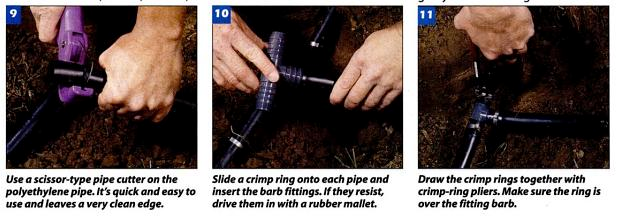

Polyethylene pipe is joined by barb fittings. These can be secured by hose clamps, but stainless steel crimp rings (Oetiker clamps) are a better choice. They’re inexpensive ($16 for 100) and are a snap to use. Cut the pipe with a scissor-style pipe cutter (Photo 9). Slide a stainless steel crimp ring onto each pipe and insert the barb fittings (Photo 10). Slide the rings in place and crimp them tight with the pliers (Photo 11). Installing The Heads

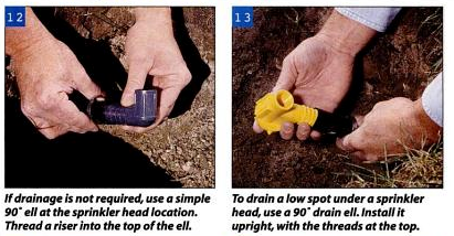

The sprinkler heads can be connected to the pipes in several ways. If drainage is not a problem, the simplest method is to install a 90˚ ell with a barb fitting on one end and a female thread on the other (Photo 12). If you’re at a low spot and need seasonal drainage, install a 90˚ drain ell instead (Photo 13).

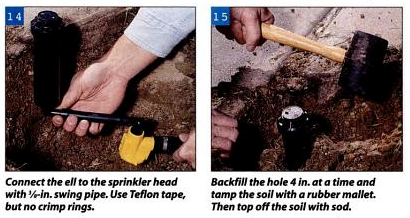

From there, you can connect a head to the ell with a threaded riser, or make an offset swing pipe. Swing-pipe connections offer a few advantages. First, you don’t need a supply pipe directly under each head, and second, offset fittings make the connection more durable. To make a swing-pipe connection, thread one 90˚ ell into the drain fitting and another into the bottom of a sprinkler head. Use Teflon tape on the threads. Then, join the two ells with a length of 3⁄8-in. polyethylene swing pipe (Photo 14). This fit is so snug that it doesn’t need a crimp ring. Finish by filling the hole while tamping the soil with a rubber mallet every 4 in. (Photo 15). When tapping into a continuous piping run, use the self-tapping saddle valve mentioned earlier.

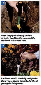

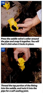

Open the collar and press the saddle onto the pipe until you feel the bottom of the valve’s collar snap together (Photo 16). Then, thread the tap into the saddle until it pierces the pipe and clicks tight (Photo 17). To connect the head, install either a swing pipe or a threaded riser in the top of the fitting (Photo 18). We equipped our entire system with three types of heads: spray heads for small areas, rotary heads for the large areas and a bubbler for the flower garden. The bubbler sends a trickle of water through 1⁄8-in. tubing to various spots in the garden (Photo 19).

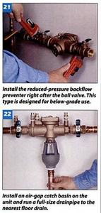

After the ball valve, install a brass nipple and the reduced-pressure backflow preventer (Photo 21).
Run piping from the backflow preventer to the pipe installed through the rim joist.
This type of backflow preventer will occasionally back surge, so you’ll need a catch basin with an air gap underneath it. Pipe the basin to a nearby floor drain with 1-in. pipe (Photo 22). The piping after the backflow preventer will also need a drain valve so you can drain the overhead line in winter. Install the control panel on a convenient wall. Run the cable into the panel, strip the wires, and connect them according to the manufacturer’s instructions (Photo 23). Outside, pull the plugs from the sprinkler heads and flush the dirt from each zone. When the water runs clear, install the grit strainers and nozzles, and make angle and volume adjustments at the heads.
