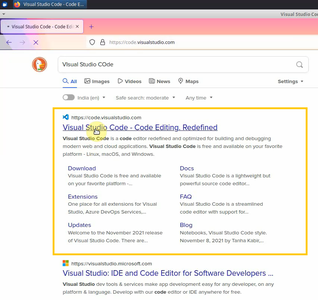

Step 1: Download VS Code for Debian, Ubuntu
First step is to download VS Code on Linux.
  1. Go to https://code.visualstudio.com/ and download the .deb version.
  2. Then a pop-up windows appears, select Save File option.
