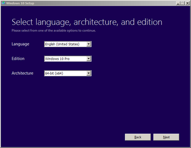

After opening the tool you will be redirected to a series of steps which involve accept the terms of use etc.
Always select the 64 bit option, only use 32 bits if you absolutely require it for personal reasons.

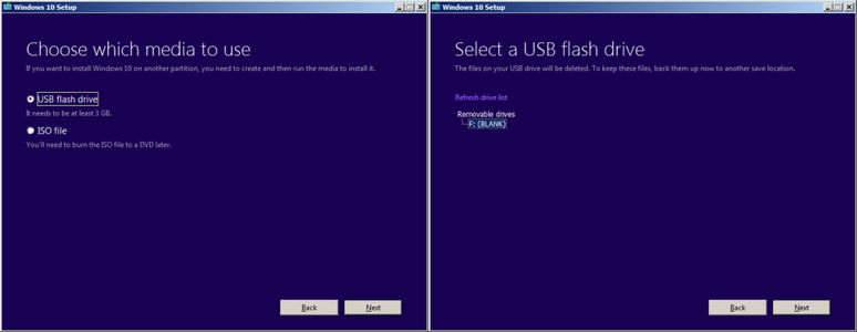

Following you will be asked if you want to upgrade or windows or if you want to create an installation media, for this case you will not be required to update your windows therefore select the installation media option.
You can then select your USB drive which will be listed under devices and drives below.
This will take a while after that step you will be done with installing windows on your USB drive.
