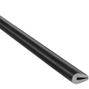

  • Rubber edge strip to cover sharp metal edges. For example see link: https://www.clarkrubber.com.au/products/15571-weather-strip-u-channel-1-5mm-x-10mm

  2. Cut a length of the rubber U-channel edging trim and insert it onto the edge of the big hole. This is really useful to prevent road vibrations from causing the metal edge to cut through the flexi tube as you don't want water to get in through any holes!
