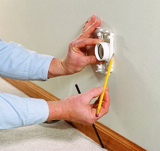

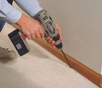

When you’ve located an empty stud space, mark its center and bore into the floor next to the wall with a long 1⁄4-in. bit (Photo 1). Leave the bit in the floor as a marker. Break the nailing flange from a plastic mounting bracket and hold the bracket against the wall, about 12 in. above the drill bit. Trace around the bracket’s flange with a pencil (Photo 2), and then cut the opening with a drywall saw.

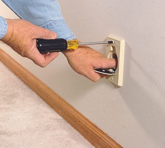

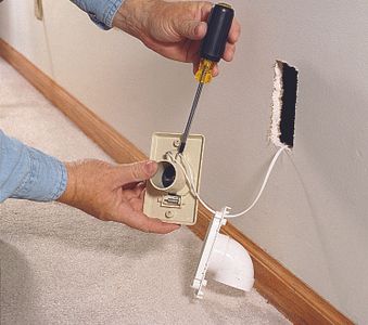

A dual ell is a special, short-radius, 90˚ elbow that fits inside a 4-in. wall. Glue one of these ells to the mounting bracket, with the open end of the ell facing downward. Pull the low-voltage cable through the mounting bracket, strip about 3⁄4 in. of insulation from each wire and bind the wires under the inlet’s terminal screws (Photo 5). Tip the bracket into the opening and pull its top and bottom flange against the wall. Reach through the opening of the inlet cover with an index finger and grip the inner surface of the ell. Carefully push the male end of the inlet through the bracket’s O-ring seal and screw the inlet to the bracket (Photo 6). Stop when the inlet is snug against the wall.

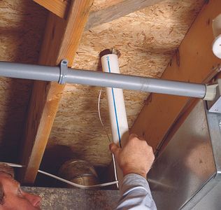

With an inlet wired and secured firmly in the wall, cut a length of pipe to feed up from the basement. File away any burrs left by the saw, and coat the leading 1 in. of pipe with PVC cement. Carefully feed the pipe into the wall and twist it one quarter turn into the inlet’s ell (Photo 1).

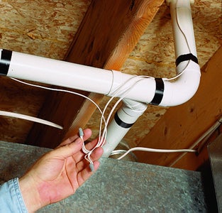

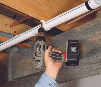

Install the remaining inlets that have basement connections and join all pipes with sweep tees on the way to the garage. At each intersection of pipe, bring the low-voltage wires together and join them with twist connectors (Photo 2). Fold the wires together and tape them to the pipe. Secure the pipe to the basement ceiling joists about every 3 ft. with the provided plastic straps (Photo 3), and extend the pipe and low-voltage wire into the garage.

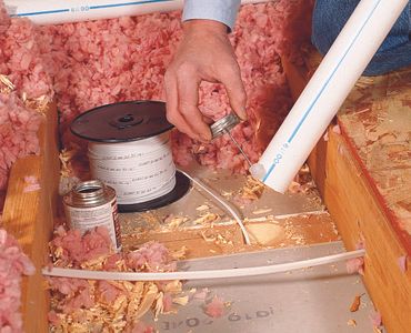

To run an inlet pipe from the attic, first use the stud sensor to find the center of a wall cavity. Use a piece of coat-hanger wire to bore through the ceiling drywall, and leave the wire in place as a marker.

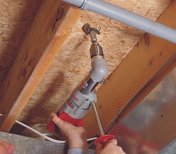

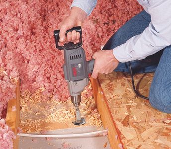

In the attic, locate the wire and remove all insulation from the area. Bore through the wall’s double top plate with the self-feeding bit (Photo 4), and use a flashlight to check the space for obstructions. Feed low-voltage cable into the opening from above, and then return to the main floor and cut an inlet into the wall. With the inlet’s ell facing up, apply glue to the end of the pipe and feed it into the wall from above (Photo 5). If a low roof leaves too little clearance for a long pipe, splice shorter pieces together with couplings.
Run the attic pipe to the garage ceiling, securing it every 4 to 6 ft., and tape low-voltage cable to the pipe at least as often. Before replacing the insulation, prevent drafts by injecting minimum-expanding foam around the pipe where it passes through the plate.

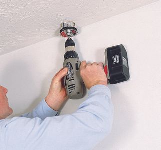

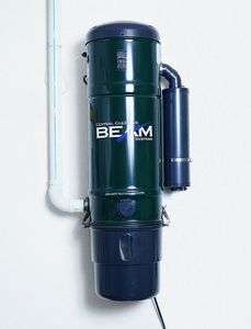

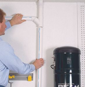

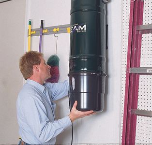

Bring the attic piping into the garage by cutting a hole in the ceiling drywall (Photo 1). Choose a convenient location for the canister and screw the unit’s mounting plate to the wall. Settle the canister onto its clips (Photo 2) and check it for level.

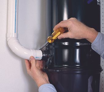

Join the line from the basement and the line from the attic with a sweep tee, just above the canister (Photo 3). Next, extend a length of pipe to meet the canister’s inlet and make the final connection with a hose clamp (Photo 4). Install the
exhaust muffler on the canister with a second clamp, and attach the low-voltage wires with push-on connectors. Finish by installing a plastic cover over the connectors.
