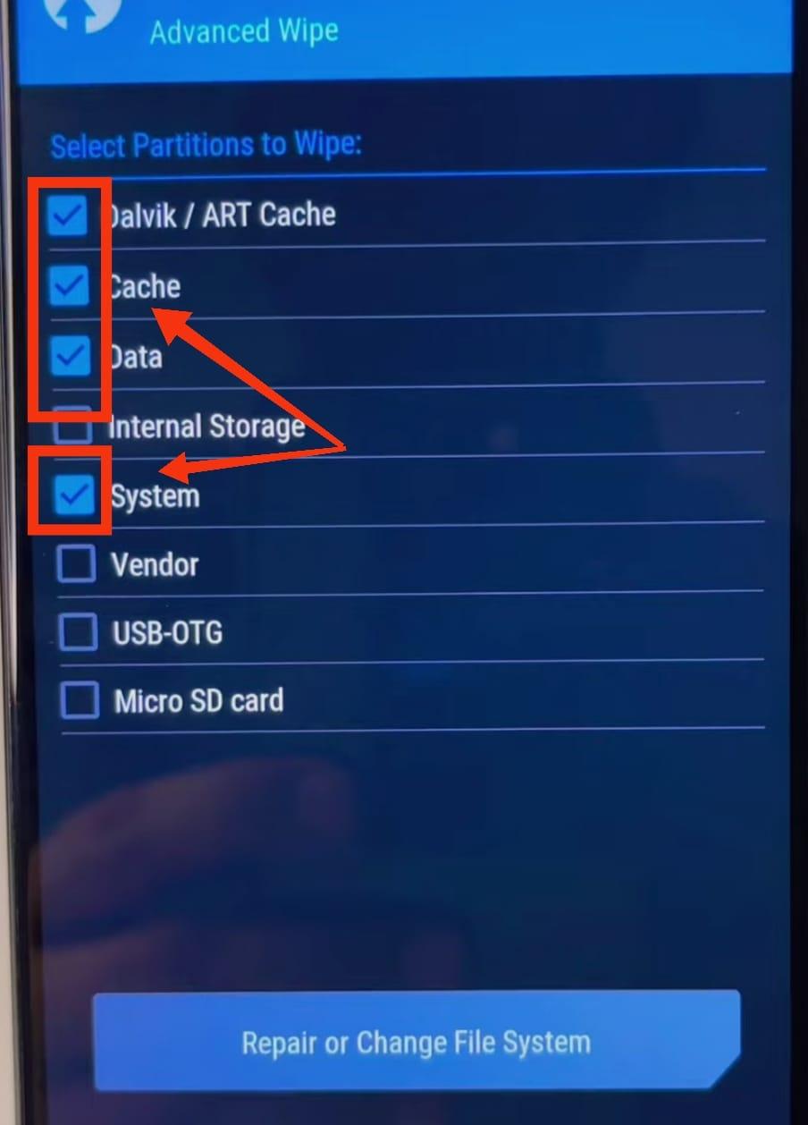

Step 4: Wipe the Old System (Dalvik, Cache, System, Data)
Before flashing a custom ROM, you need to clean up the existing system files. This prevents bootloops, crashes, or leftover junk from the old ROM.
4.1 Boot into TWRP
  1. If you’re not already in TWRP, power off your phone.
  2. Hold Volume Up + Power until the TWRP recovery screen appears.

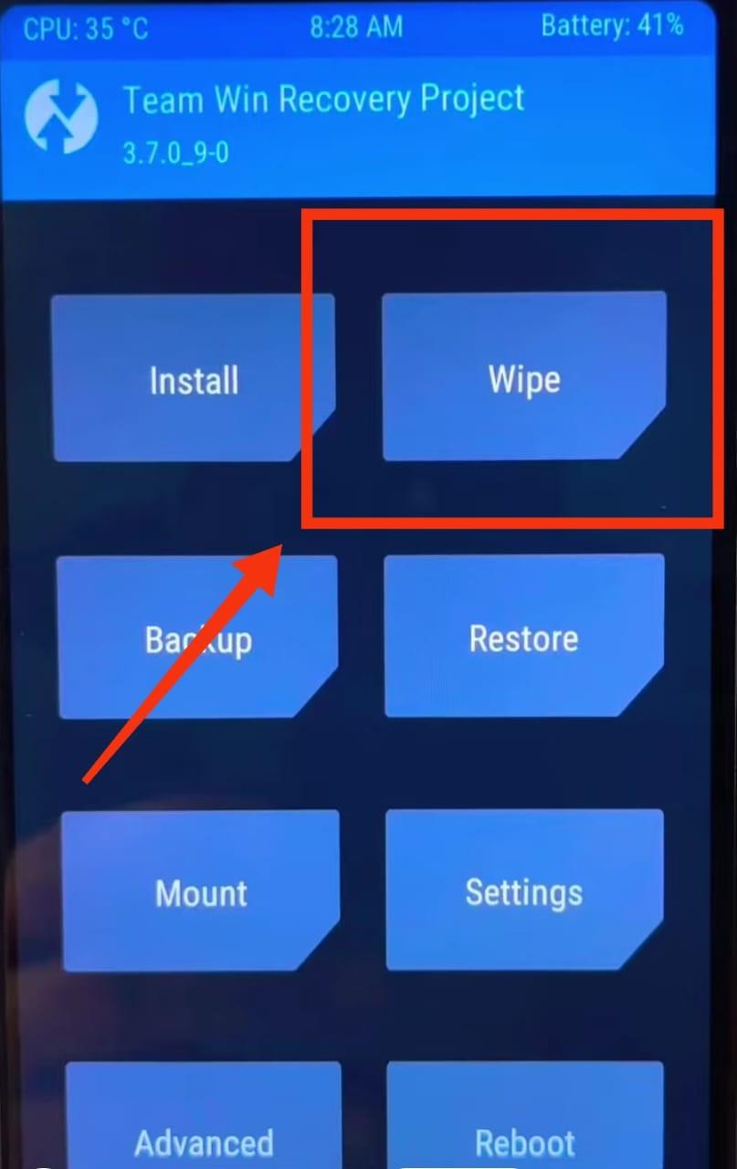

4.2 Go to Wipe Section
  1. In TWRP, tap Wipe.
  2. Then tap Advanced Wipe.

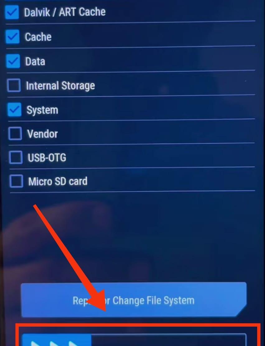

4.3 Select Partitions to Wipe
Check the following boxes:
  1. Dalvik / ART Cache
  2. System
  3. Data
  4. Cache
Do NOT select Internal Storage (this contains your ROM .zip, GApps, and files).
4.4 Swipe to Wipe
  1. Swipe the slider at the bottom to confirm.
  2. This will erase the old Android system while keeping your downloaded files intact.
4.5 Why This Step Is Important
  1. Dalvik/ART Cache: Clears old compiled app code.
  2. System: Removes the old Android OS.
  3. Data: Removes apps and settings from the old ROM.
  4. Cache: Clears leftover temporary files.
This ensures a fresh environment for your new ROM.
Now your phone is completely clean and ready for the ROM installation in Step 5.

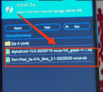

5.1 Transfer Files to Your Phone
Make sure you already copied these .zip files to your phone’s internal storage or SD card:
  1. ROM .zip (e.g., lineage-20.0-2025-01-01-karate.zip)
  2. Google Apps (GApps) .zip (optional, only if you want Play Store & Google services)
  3. Magisk .zip (optional, if you want root access)

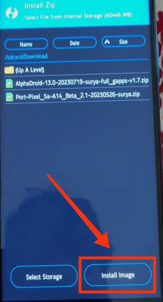

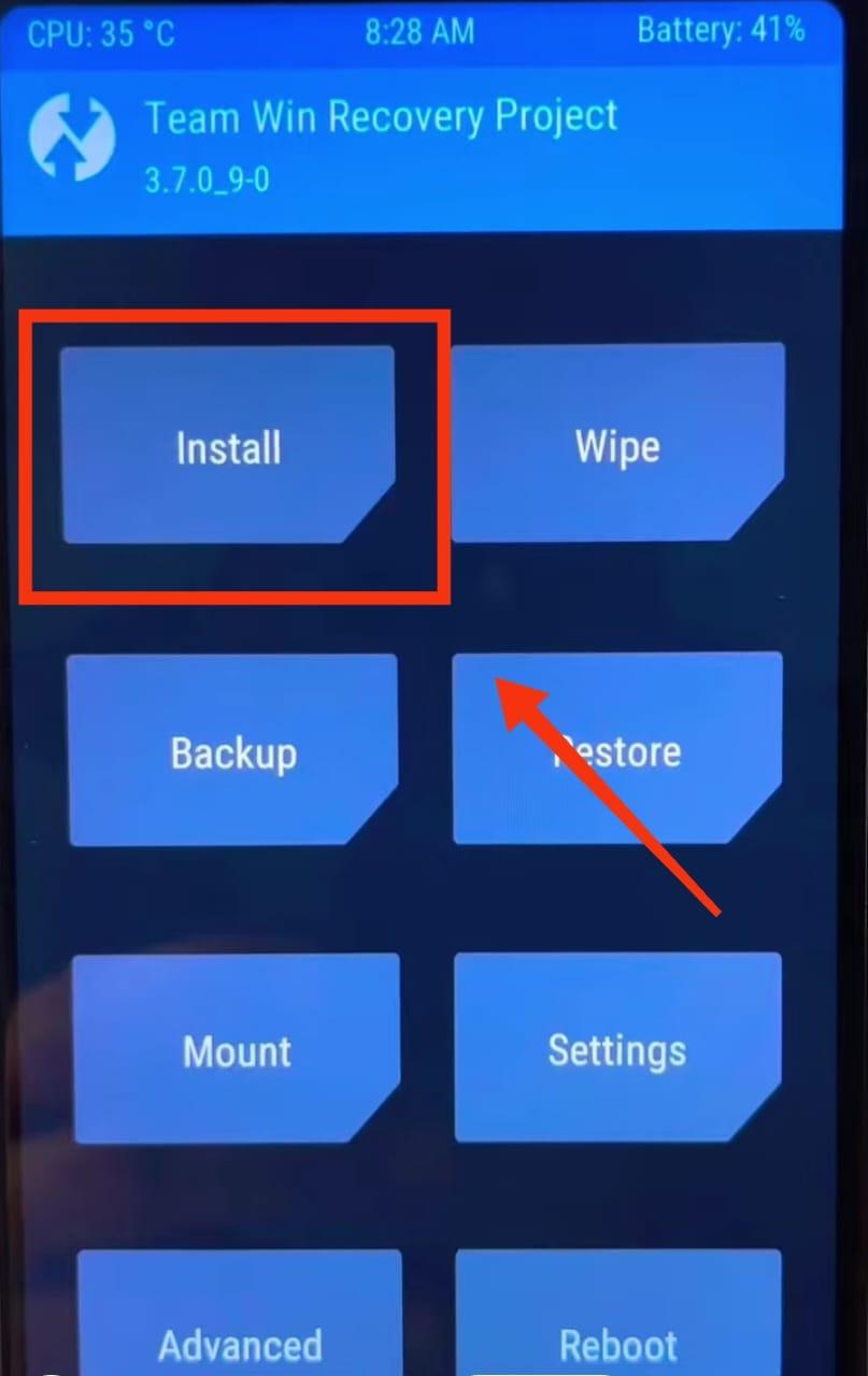

5.2 Flash the ROM
  1. In TWRP, tap Install.
  2. Navigate to the folder where your ROM .zip is stored.
  3. Select the ROM file (e.g., lineage-20.0-2025-01-01-karate.zip).
  4. Swipe to confirm flash.
  5. This will take a few minutes.

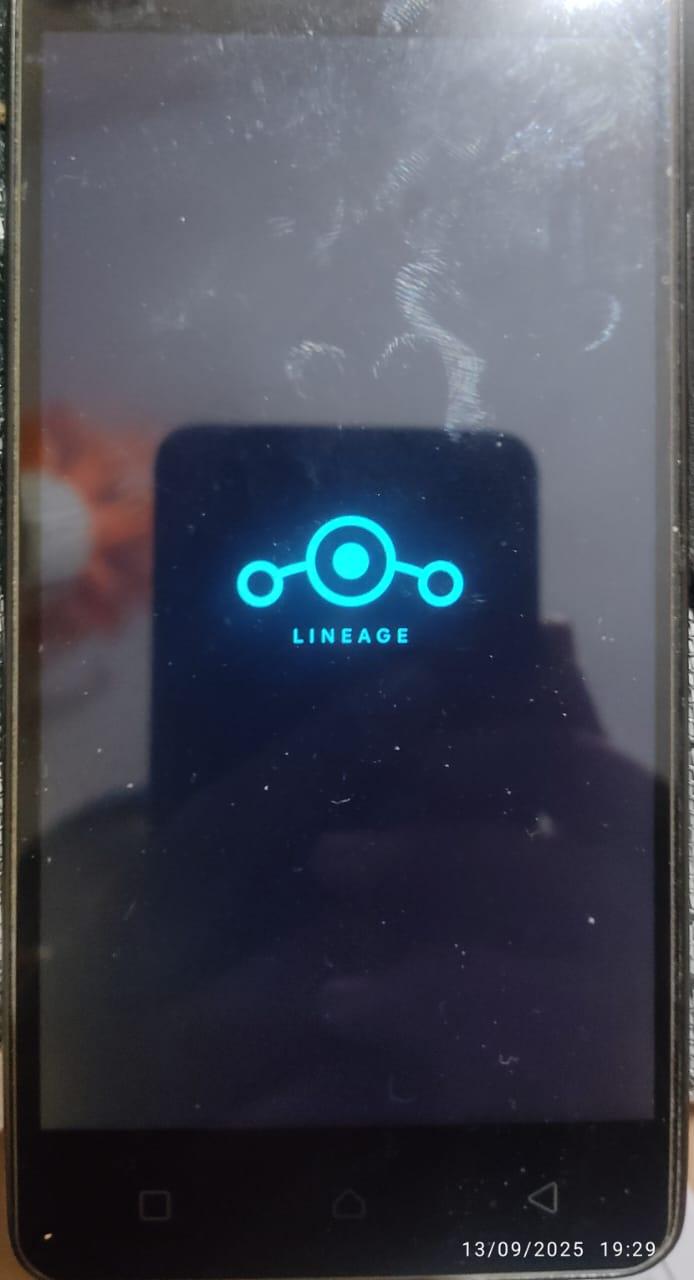

Your phone now has the custom ROM installed and is ready to boot into the new system. Next, we’ll reboot and set it up.
Step 6: Reboot & First Setup
Now that you’ve installed your custom ROM (and optionally GApps), it’s time to boot into the new system.
  1. In TWRP, tap Reboot → System.
  2. The phone will restart and begin loading your new ROM.

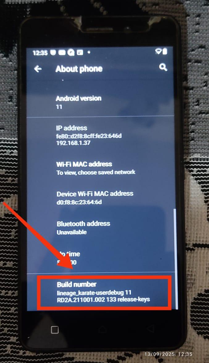

  6. Once the setup screen appears, follow the on-screen instructions:
  7. Connect to WiFi.
  8. Sign in with your Google account (if you installed GApps).
  9. Set up fingerprint/lockscreen and restore apps if you wish.
Tip: After the first boot, give your phone some time (10–15 minutes) to settle down. It might feel slightly slow at first while background processes finish.
Congratulations! You’ve successfully installed a custom ROM on your phone. Now you can enjoy new features, updates, and a fresh look beyond what your manufacturer originally provided!!!
