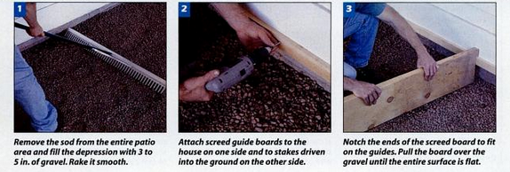

Begin site preparation by removing the sod in the patio area. Then spread gravel on the site using a shovel and rake (Photo 1). Next, attach screed guide boards to the house and to stakes driven into the ground on the other side (Photo 2). The boards along the house should be level from side to side. The opposite boards also should be installed level from side to side but located lower than the house boards to accommodate the necessary slope mentioned above. Next, cut a notch in both ends of a screed board to fit over the guides. Pull the screed across the gravel until the surface is flat (Photo 3). Add or remove gravel from areas as needed.

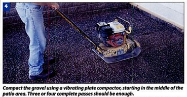

Once the surface is flat, compact it with a plate compactor (Photo 4), available at tool rental stores for about $50 a day. If you haven’t used one of these machines before, it’s a good idea to work in the center area of the patio site first. These machines can be hard to control, so it’s smart to get comfortable with your machine before you work close to the house. Make at least three passes over the entire area, overlapping passes by half a plate width each time. Add a few inches of sand and spread it with a shovel and a rake. Then screed it to finished depth and flatness with another screed board (Photo 5), using the guide boards to support the ends. Compact the sand with a plate compactor as you did with the gravel.

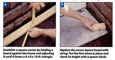

Before you begin placing stones in the sand, you must establish a square corner. To do this take a long, straight board and place one end against the house where the patio corner will fall. From the corner point, measure over 6 ft. along the house wall and make a mark. Then, measure 8 ft. along the board from the house and make another mark. Have someone hold the end of a tape measure at the house mark and adjust the board until the 8-ft. mark intersects the 10-ft. mark on the tape (Photo 6). Drive a stake at the end of the board and tie a string from the house corner to this stake. Tighten the string so it is the height of a scrap block of wood above the finished surface of the stone. By aligning the edge of all the end stones with this string, your installation will start square.

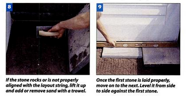

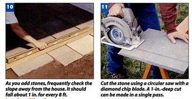

With your square starter string in place, slide the corner stone into position. Check its height by sliding your scrap block between the string and the stone (Photo 7). Then check for level from side to side. To make the stone fit properly, lift it up and either add or remove sand from the base using a trowel (Photo 8). Lay the next stone in your pattern. Maintain a joint of about 1⁄2 in. between the stones and check that the matching edges of the stones are flush and that the second is level with the first from side to side (Photo 9). As you add more stones always make the edges meet flush and check the overall slope frequently, especially as you work farther from the house.

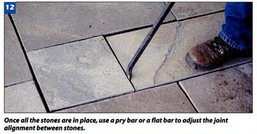

A long board with a 4-ft. level on top should keep you in the ballpark (Photo 10). Cutting stone is easy—though very loud and messy—using a circular saw with a masonry blade that has diamond chips bonded to the edge. These blades cost about $15 each and can cleanly cut through 1-in. stone in a single pass (Photo 11). They work much better and last longer than the commonly available aluminum oxide abrasive blades. Once all the stones are laid, align the grout joints using a pry bar or flat bar (Photo 12).

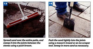

You’ll have to make some compromises on this step because not all the joints will line up perfectly. Just favor the ones that will be more visible and let the others fall where they fall. You can grout the joints with either sand—which we used—or stone dust that’s available from your stone dealer. Spread the material you choose over the patio and use a push broom to fill the joints (Photo 13). Pack the grout into place with either a mason’s trowel or an ice
