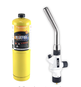

Map gas torch

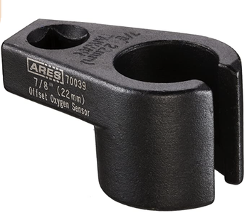

Oxygen sensor wrench

Torch the bungs of each oxygen sensor to get them nice and hot, then use an oxygen sensor socket to remove the oxygen sensors from the exhaust manifold. Once all the sensors are removed from the exhaust manifold, install them into your new hearer.
