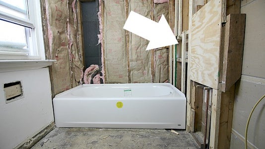

Step 1: Add Wood Blocking...the Essential Ingredient
The most important thing for wall mounted sinks is to have wood blocking in the wall.
Plywood is inside the wall in the picture below.
This plywood is for the wall mounted sink. Steve added drywall to the studs and tiled over it.
Screws will be anchored to that plywood and hold the sink securely to the wall. If you want a super solid installation you need wood blocking. A piece of 2×10 wood can also be used in place of plywood. Either toenail the wood or screw it to the adjacent studs. In any case, wall mounted sinks need wood blocking!!

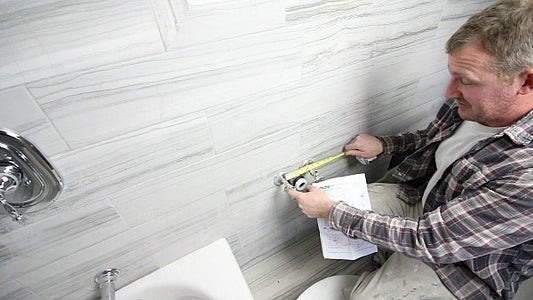

Step 3: Get the Plumbing Right...the First Time!
In the video Steve mentions a potentially fatal mistake:

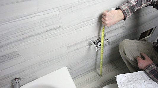

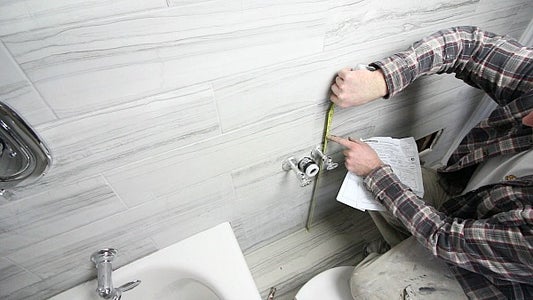

Incorrect valve stem spacing. Get this wrong and your project could be a nightmare. Valve stems for the Ravenna need to be 3 inches apart.
Otherwise the shut off valves won’t fit inside the pedestal.
Bottom line, adjust your plumbing before finishing the wall. The height of the shut off valves should be around 24 3/4″ off the finished floor.
Drains should be 21 inches off the finished floor.

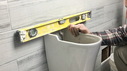

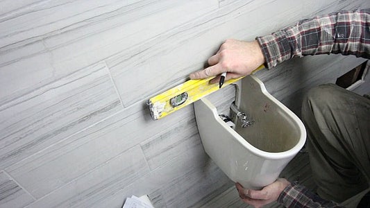

Step 4: Install the Floating Pedestal
In the video Steve explains that from the top of the pedestal to the top of the sink is about 7 inches.
Remember that reference mark for the sink height…yep, it’s important. Measure down 7 inches from that 35 inch mark and that’s the height for the pedestal. Set a level on the pedestal and mark the position of the pedestal holes on the wall.

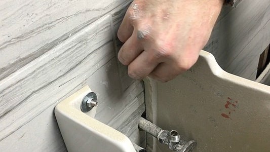

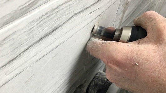

Know the location of the pipes in the wall before drilling holes!! Holes in water supply lines or drains are not good. That’s obvious, but nonetheless you could get caught up in the moment and not realize a hole is being drilled into plumbing. We had to cut holes in the wall tile using a diamond hole saw.
The proper technique for doing this is to hold the bit at a 45 degree angle to get it started in the tile.
Then slowly tilt the bit to 90 degrees.
Our video shows this is detail. We used a 1/2 inch diamond hole saw with a standard drill but you can also use impact drivers. Thread the screws for the pedestal into the wood blocking using pliers. Just be careful not to damage the threads for the nuts.
Then temporarily mount the pedestal to the wall using washers and nuts. It doesn’t have to be super tight at this point.
In addition, check the pedestal is level.

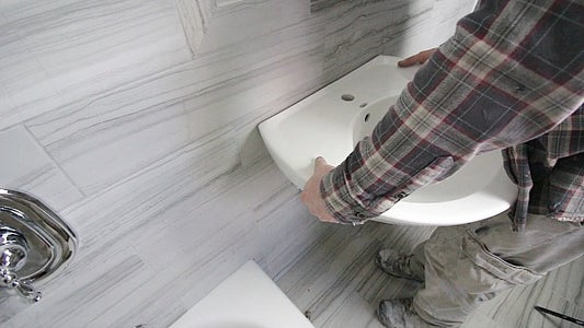

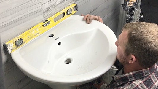

Place the sink on the pedestal and double double check for level (yes, I meant to say that).
It never hurts to double or triple check.
Then mark the holes for the sink and cut them using the diamond bit. The lag screws for the sink were bigger than those for the pedestal. So we predrilled the wood blocking with a 1/4″ drill bit and installed the screws with pliers.

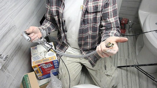

Step 5: Install the Faucet...Make It Leak Proof and Rock Solid
Faucets are way easier to install when the sink isn’t mounted to the wall.
We used the American Standard Portsmouth single-handle faucet on this project.
Side note on single-handle faucets:
They’re my favorite choice in bathrooms because there’s only one cartridge to replace. In addition, I think it’s easier to clean single-handle faucets. Just my opinion for what it’s worth.

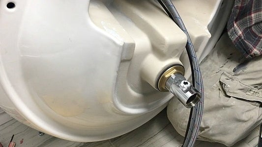

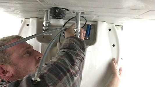

The Ravenna already has the supply lines connected to it. Which is great because it’s one less step.
Plus, the speed connect drain control cable makes the pop-up assembly easy.
I hate messing around with traditional pop-ups and love the speed connect.
Start watching our video at the 10:00 mark to see the faucet installation in detail.

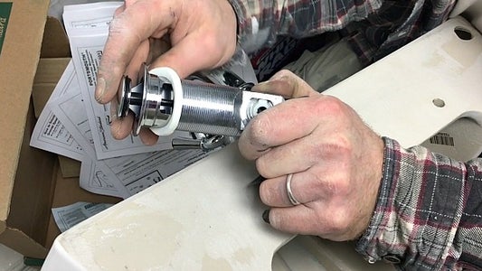

Disassemble the faucet retaining nut and slide the faucet onto the sink. Just make sure the rubber gasket is between the faucet body and sink. Then position the washer between the underside of the sink and retaining nut. Tighten the nut with pliers and your done. The Portsmouth drain has foam gasket that seals it to the sink.
There’s no need to use plumber’s putty or silicone because of this gasket.
Slide the drain into the sink then add the rubber washer, plastic slip ring, and brass nut to the underside. Tighten the brass nut with a set of pliers. Make this connection tight since it’s a potential area for leaks.
Attach the speed connect drain control cable to the drain and then add the drain pipe.
Steve shows how to apply silicone to the pipe threads to avoid leaks. I thought this was a fantastic tip, especially for this type of sink. Add the sink to the wall and secure it using lag screws.
This part can be tricky if you’re alone but fortunately the human body has two hands and head to support sinks, haha.

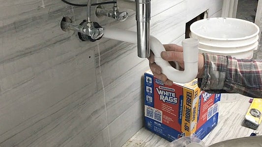

At the 12:47 mark in our video Steve explains how to install the P-Trap.
Here’s a PRO TIP:
Cut the goose neck going into the wall such that there’s a 1 inch gap between it and the back of the wall pipe.
This prevents clogs from occurring in the P-Trap assembly.
Steve does a good job of explaining this concept in the video. Use a Ridgid tail piece extension tube cutter to trim the goose neck. A hacksaw can also be used but the tube cutter is quicker by far my favorite tool for cutting PVC pipes.
Ensure all the washers face the right direction and tighten the three slip nuts by hand. The slip nut at the gooseneck to wall pipe connection should be tightened 1/4 to 1/2 turn more with pliers.

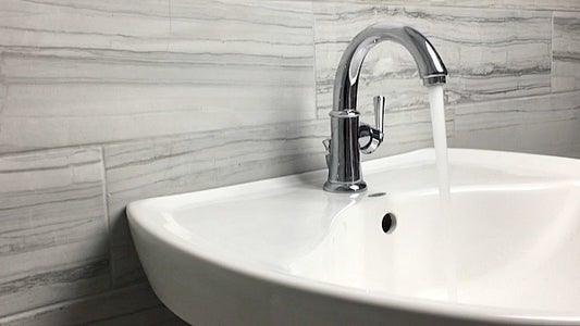

Test the faucet by turning on the water and check for leaks at all your plumbing connections.
There’s nothing worse than a water leak after the sink is installed!!
The last step is to install the floating pedestal. We used a combination wrench to tighten the nuts because the space was a bit tight for a ratchet. Watch our video for more tips as some of them are easier to see than explain in writing.

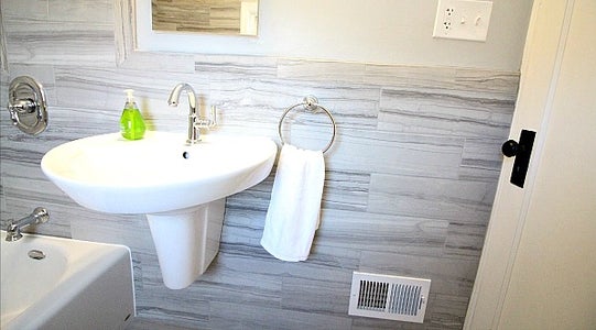

Overall, we think this sink looks awesome.
We hope our tutorial was helpful.
