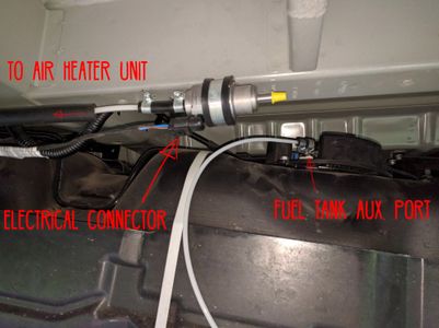

Step 7: Plan the Routing of the Fuel Line and the Fuel Pump Electrical Wire
We used a heat shield where the fuel line crossed above the van exhaust.
Step 8: We Located the Fuel Pump Near the Fuel Tank (as Stated in the Manual). the Fuel Pump Was Attached Using a PlusNut Fitted in an Existing Hole
To gain access to the auxiliary fuel port, the tank must be lowered.
We drove the van until about 10 miles to empty (the tank is surprisingly lightweight at this point). Then we put a toolbox under the tank and removed the 6 screws holding the tank. No need to detach the fuel lines (they are flexible). We lowered the tank until we were able to detach the protective fuel cap on the auxiliary fuel port.
