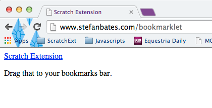

- Go to http://stefanbates.com/bookmarklet.html
- Click and drag the link to your bookmarks bar.
- Thats it!
