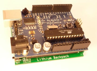

Introduction: How to Install the Arduino to the Lithium Backpack
The Arduino is an open source hardware input and output circuit and the Lithium Backpack is a Ardino accessory that will power the Arduino when it is away from a computer or a wall power. These products are sold at Liquidware for under $34 each.

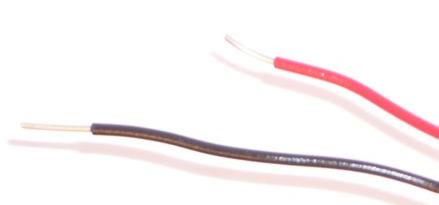

Step 2: Plug the Ground Pin in With 22-24 Gauge Solid Core Wire.
Black wire is recommended to avoid confusion.
The wire will connect the Ground on the Arduino to the Ground on the Lithium Backpack.
Step 3: Plug the +5V Pin in With 22-24 Gauge Solid Core Wire
Red wire is recommended to avoid confusion.
The wire will connect the +5V pin on the Arduino to the +5V pin on the Lithium Backpack.

Step 6: Attaching the Backpack Allows the Arduino to Be Portable
Use the 2 plastic screws, spacers and nuts to attach the Backpack to the back of the Arduino.
