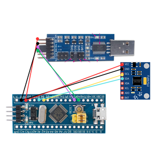

Step 1: Hardware Connections
The first step is to connect the MPU6050 to the STM32 Blue Pill. Here’s how to wire them together:
Power Supply:
  1. Connect the VCC pin of the MPU6050 to the 3.3V pin on the STM32 Blue Pill.
  2. Connect the GND pin of the MPU6050 to the GND pin on the STM32 Blue Pill.
I2C Communication:
  1. Connect the SCL pin of the MPU6050 to the PB6 pin on the STM32 Blue Pill (default SCL pin for I2C).
  2. Connect the SDA pin of the MPU6050 to the PB7 pin on the STM32 Blue Pill (default SDA pin for I2C).
