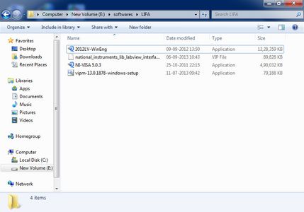

Step 4: Keep All These Files Ready Before You Start Installation !
1) LabVIEW.exe
2) Ni-Visa.exe
3) Vipm.exe
4) LabVIEW interface for Arduino.vip
2) Ni-Visa.exe
3) Vipm.exe
