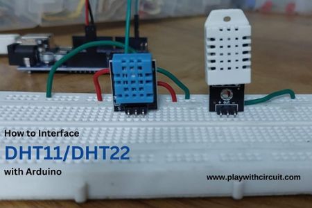

Step 3: Wiring Diagram for Interfacing DHT11 and DHT22 Sensor to an Arduino
  1. Connect VCC of the sensor to the Arduino's 5V pin.
  2. Connect GND of the sensor to the Arduino's GND pin.
  3. Connect Data pin to a digital pin D2 on the Arduino with a 10kΩ pull-up resistor between the data pin and VCC.
