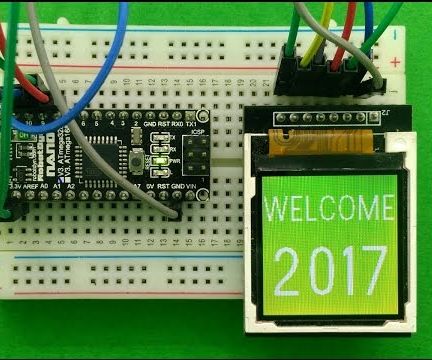

Step 2: Connections
Connect your Arduino & Oled display as shown in Image. Connection are very Simple
ARDUINO-------------->>OLED
3.3V---------------------->>VCC
GND--------------------->>GND
A4------------------------>>SDA
A5------------------------>>SCL or SCK

Step 4: Run the Code!!
After successfully installing the library Open you Arduino IDE software and go to
Files->Example->u8glib->click on Graphic test
After this click, you'll get new window opened and you need to uncomment this line from the code as shown below
//U8GLIB_SSD1306_128X64 u8g(U8G_I2C_OPT_NO_ACK); // Display which does not send AC
To This
You just need to remove two slashes that`s all now just set your Arduino board and port and Upload the code and watch the graphics on OLED display .
