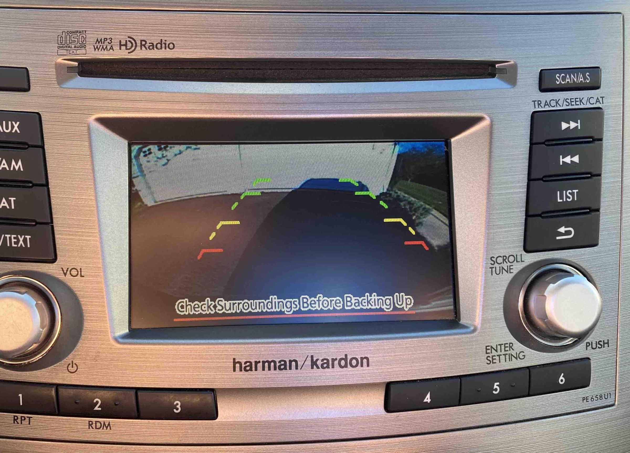

I recently replaced the backup camera on my 2014 Subaru Outback. I was a little apprehensive after watching videos on removing the old camera, and seeing nuts drop inside the door panel. I thought that maybe I could magnetize my socket wrench with a magnetizer/demagnetizer, but when I tried, I could barely pick up a paper clip. Then I thought about using mounting putty, and it worked well.

Step 3: Conclusions
I am happy to say that I successfully replaced the backup camera. Replacing the camera was a bit laborious, but not too difficult. Using the mounting putty on the socket prevented the nut from falling out of the socket.
