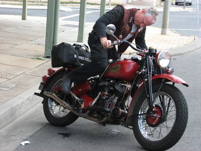

Step 2: Kick the Thing
Now you're ready to start stomping the kick start pedal. You may have to mess around some to find the best starting position, but for motorcycles it's usually straddling the bike, kicking the start pedal with your right leg in fast, downward motions. You may need to play with the choke or give the bike a little gas to coax it out of it's slumber, but unless you've got other problems the bike should start with a few swift kicks. Scooters are generally kick started standing to the side, holding the brake. If you have a manual compression release you may need to re-engage it every couple kicks.
