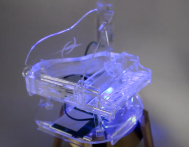

Step 7: Complete the Laser Cutting
Once assembled, step back and admire your miniature acrylic piano. Whether clear and modern, or colored for a playful touch, it’s a beautiful piece that reflects both craftsmanship and creativity.
My acrylic piano is finished—how about yours? With just a laser cutter, a sheet of acrylic, and a bit of patience, you can create a miniature masterpiece that’s uniquely your own. I believe you can make an even better version—so grab your design file, start your laser, and let’s see your piano come to life!
A laser cut acrylic piano model
