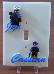

Step 2: Create Your Design in Adobe Illustrator
Using an actual switch plate, I created a large plate design that is 1" bigger than the jumbo plates you find at the local hardware store. I also created a backing "ring" that is fused to the back of the plate, giving it some volume.
I also created simple burst designs and platforms that the Lego people can stand on.
I made the names Cassian and Jyn in script, so they would stay together as a single unit. My plan was to use them as a platform for those characters, so I needed a solid surface to work with.
I always dedicate one layer of my design to virtual 'testing', where I use references, like a block that represents an average Lego person, to layout my designs and make sure everything fits. I make my references green, which is a color that does not affect my laser. That way, I can add references to drawings without fear that the laser will accidentally cut, raster or engrave them!

The only disadvantage is that is doesn't work on all plastics. I tried to use the solvent cement to fuse Lego people onto a store bought plate and it didn't work, probably because the plate was nylon. Fortunately, Lego people are made out of acrylic and fuse nicely to the acrylic plates and components.
The liquid solvent is sucked up into a syringe bottle and squirted carefully on the join between two pieces of acrylic. The fluid automatically wicks into the opening, and a very little bit goes a long way.
Step 5: Fuse the Components Together
I started by fusing together the multi-layer bases. It only takes a minute for fused pieces to dry enough to move on to the next step!
Then I fused the Lego people to their bases.
While they were drying, I fused the backing ring to the back of the switch plate. This is optional, but it guarantees a tighter fit against the wall.
Then I fused characters and their bases to the switch plate. In the cases of Cassian and Jyn, I also tack-welded the heads to the plate, for extra support. For the other characters, they were secure enough by just fusing them to their bases. This leaves them flexible and somewhat pose-able, even after they are attached.
