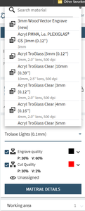

Now is when you should begin setting the material parameters for engraving. Measure the thickness of the material you are using and try to find a preset for the material. If you cannot find one, do a quick internet search for parameters. Below are some common steps you can try if you cannot find anything:
Material Database:
  1. Open the Material Database and select ‘Wood’. Ruby will display predefined settings such as power, speed, and frequency for different types of wood.
  2. For hardwoods like maple or oak, you may need to lower the speed and increase the power for a deeper, more visible engraving.
Engraving Settings:
  1. Power: For an image engraving, start with around 60-80% power for hardwoods. Softer woods may only need around 50%.
  2. Speed: A slower speed allows for more detailed engraving. Try starting with a speed of 30-40%.
  3. Frequency: Higher frequency settings work well for wood; setting it around 500 Hz will typically yield a good balance of depth and clarity.
  4. Adjust these settings based on the wood type and your desired engraving depth. Run a small test engraving on a scrap piece of wood if possible.

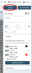

Step 6: Start the Engraving and Cutting
Add to queue: Begin the engraving process from Ruby by adding your job to the queue and then go over to the laser machine. Ensure there is no other job in progress and that yours is showing on the screen. Press the play button!
Stay nearby to monitor the progress, especially if you’re engraving a larger or complex image. Wood can sometimes produce smoke, so ensure your ventilation system is active.
Inspect for Quality: If you notice any discrepancies, you can pause or stop the job in Ruby. Adjust the settings if necessary and restart.
