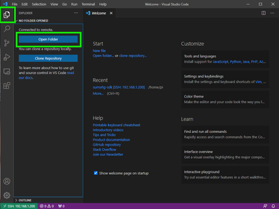

Connect to your Raspberry Pi by clicking the green "Open a Remote Window" button and then click "Remote-SSH: Connect to Host..." as shown in the image above.
You should see your Pi's IP address like in the image above. Click it to connect to the Pi. If you don't see your Pi's IP address there, follow the instructions in our earlier guide on the remote SSH setup.

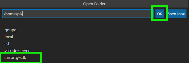

To get the latest SDK updates, first open the Explorer panel on the left side of VSCode and click on "Open folder" as shown in the image above. Select the folder named surrortg-sdk, click on "Ok" and enter your Pi's password.

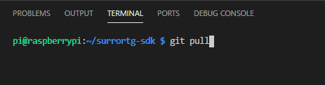

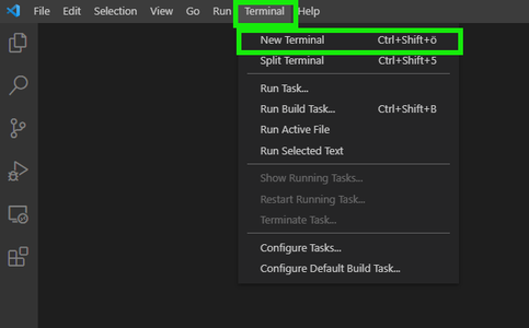

Then open a new terminal by selecting "Terminal" and "New terminal" from the VSCode menus. Use the git pull command in the terminal to update the SDK.

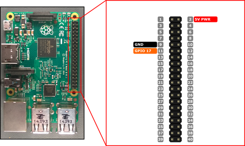

Let’s start by connecting the servo to the Raspberry Pi. To supply power, connect the red wire to a 5 volt pin and the brown one to a ground pin. You can use the pins shown in the picture above. Then connect the orange position control wire to the GPIO pin number 17 as shown in the image.
