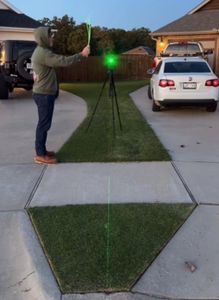

  3.  Set up the rotary laser level: Find a stable and level spot in your yard where you can set up the rotary laser level. Make sure it is positioned in a way that allows the laser beam to sweep across the entire lawn area you want to level.
  4.  Establish a reference line: Turn on the rotary laser level and adjust it to emit a horizontal laser beam. This laser beam will serve as your reference line for leveling the lawn. Position the laser level at a height that suits your desired level for the lawn.
  5.  Install the receiver: Attach the receiver to a leveling rod or a stake. Place the rod or stake at one end of the lawn area, ensuring it is firmly planted in the ground and visible from the rotary laser level. The receiver will detect the laser beam and indicate variations in the lawn's height.
  6.  Measure the uneven areas: Walk across the lawn with the receiver and record the measurements indicated by the receiver at various points. This will help you identify the high and low spots in the lawn.
  7.  Adjust the lawn surface: Using this information, you can now start adjusting the lawn surface. Focus on the areas that need to be leveled. For low spots, add topsoil or fill material to raise the surface. For high spots, remove excess soil or consider adding sand or compost to level it with the rest of the lawn.
  8.  Recheck and repeat: After making adjustments, recheck the lawn surface using the rotary laser level and receiver. Continue to adjust the low and high spots until you achieve a uniformly level lawn. Be patient and take your time to ensure accuracy.
