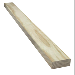

1 2x4x12 piece of wood

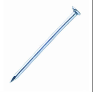

1 large nail (6-10 in long)

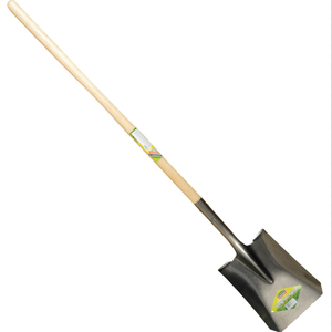

1-2 shovel(s), flat

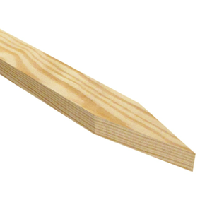

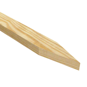

4 wood stakes

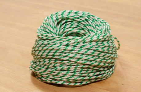

1 roll of twine (yarn/rope)

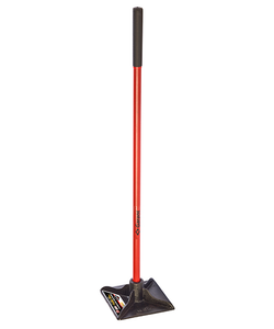

1 steel tamper

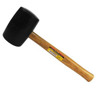

1 rubber mallet (or steel hammer)

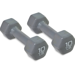

2 ten-pound weights

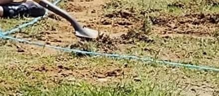

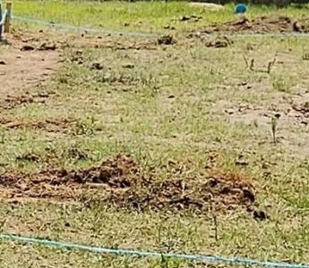

Step 1:
Use the stakes and twine to create a squared area to dig up.
For this example, a 20 ft x 20ft area.
Step 2:
Use the Flat shovels to dig up 2-4 inches of sod/ground.
Use wheelbarrow to move dirt away from the area.
Step 3:
Use a steel tamper to flatten and level the ground.

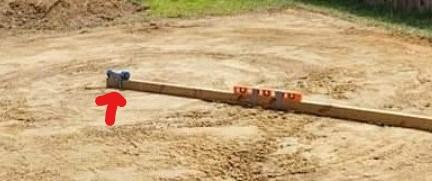

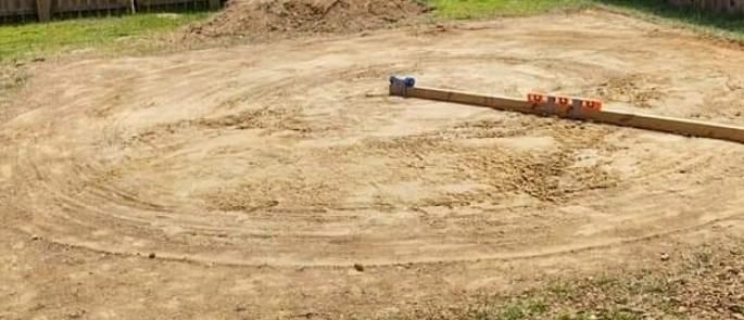

Use a rubber mallet to nail the 2x4x12 wood piece in the center of the dug-out square.
Nail the piece of wood at two feet in, leaving 10 feet for the leveling.
Step 5:
Duct tape leveler to the piece of wood.
Then duct tape the two ten-pound weights at each end for stability.

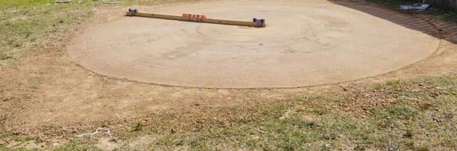

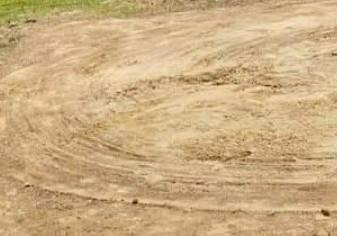

Step 6:
Attach the Rope or remaining twine at the end of the piece of wood (opposite of the center).
Then begin moving in a circle to smooth out the area.
Step 7:
Use leveling sand to fill in gaps and create a smooth surface while continuously moving in a circle.
Once Leveled you will be ready to set up your above ground pool.
