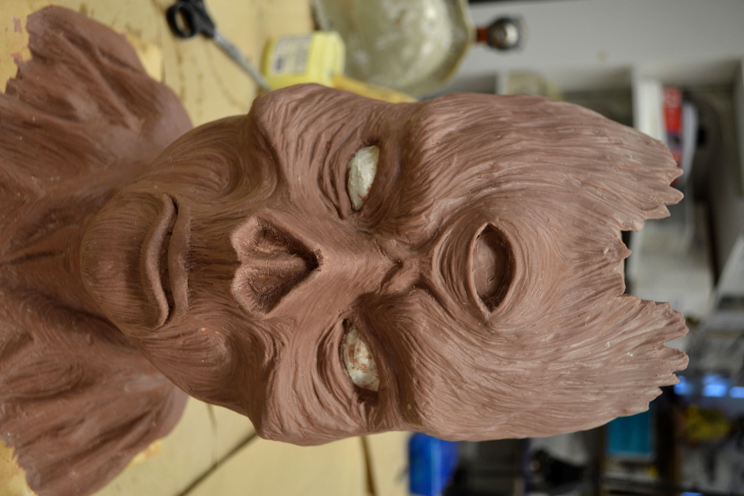

After the mold is removed from the face, you should immediately begin to mix the Ultracal 30 to fill the mold. You don’t need to rush, but the alginate will start to shrink irregularly as soon as it cures, so it is not ideal to wait to fill the mold.
When you mix Ultracal, remember when you fill your mixing bucket with water, it will double in volume when you add the cement. It is better to have too much mixed up than too little, but you also don’t want to be wasteful.
1. Peel out the cured alginate from your bucket and fill it with tepid water to the desired level.
2. Add the Ultracal by sprinkling it onto the surface of the water. It will sink to the bottom of the bucket. Add cement until you have a small island in the water.
3. Mix for 2-3 minutes with a mixing attachment on a drill. Stop and check for any chunks that still need to be broken up by hand. (The material will be strongest if a mechanical mixer is used, but you can mix by hand).
4. Pour the mixture slowly onto the inside surface of the mold, just as you would pour beer down the side of a glass. This helps avoid air bubbles. You could also pour a small amount of the cement into the mold and use a brush to smooth it in, but I feel that in this circumstance, attempting a beauty coat is unnecessary if it is poured properly.
5. The cure time will depend on the size of the piece, but generally a face cast takes about half an hour before you can remove the alginate and plaster jacket, and a head cast takes about an hour. You should wait a full 24 hours before you begin to sculpt on the plaster, allowing it time to fully cure and harden.
