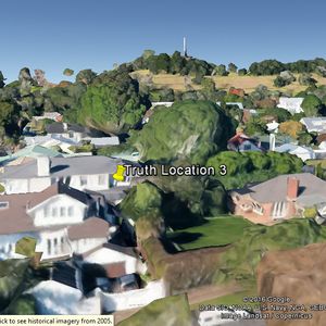

Step 9: Finding Likely Truth Locations
In order to be more efficient with your searching, I would recommend scouting out potential places before venturing out. Google earth is a very useful tool to help you do this. You can set placemarkers at the true altitude and see where they intersect with building and landmarks.
Step 10: Go Out and Look
Now you are aware of the approximate locations, go visit these places with the truth finder and see how close you can get to the truth. Good Luck!
