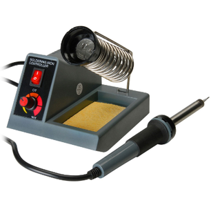

This section will explain the tools of the trade. Some of these you will need, some of these you will not. The first (and most common) apparatus is the simple yellow sponge.
Yellow Sponge: The purpose of the sponge is as follows; the sponge is porous, so it holds water. Rubbing a hot soldering iron tip on a wet sponge causes the solder to contract at a different rate than the soldering iron, helping to knock off any globs of solder that may be clinging to the tip. NOTE: Make sure the sponge is damp (not soaked) with water.

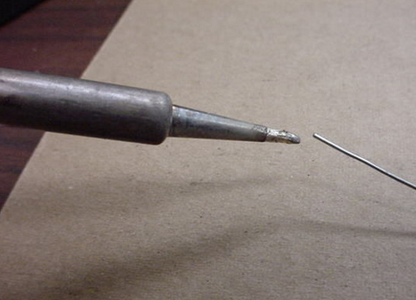

Scenario 1: Someone left me with a cold & dirty iron. This is common in some workplaces / college electronic labs, etc. If the tip of the iron is covered in gunk, it may not heat properly, even if you heat it up, and use the steps listed under Scenario 2. If this is the case, unplug the iron and allow it to cool. After the iron is cool, lightly scuff the surface of the iron tip with 600 grit (or higher) sandpaper until it begins to gain some luster again. You are not trying to remove metal, just the oxidation. (notice the tip of the iron in the provided picture).

After cleaning the iron, its a good idea to tin the tip. We will achieve this by allowing a thin coating of solder to cover the tip of our iron. This will protect the iron from oxidation as the solder serves as a sacrificial buffer zone against oxidation (it oxidizes rather than our tip oxidizing).
To tin your tip, use a tinning compound, available at RadioShack or hardware shop. If a tinning compound is unavailable, you can substitute this with regular electronics solder.
I recommend a low temperature solder for this because you want the iron to cool fairly quickly, so you don't fry the solder onto your tip which would defeat the purpose of cleaning. A properly tinned tip will look similar to the tip below. A properly maintained soldering iron will give you years of flawless service.
