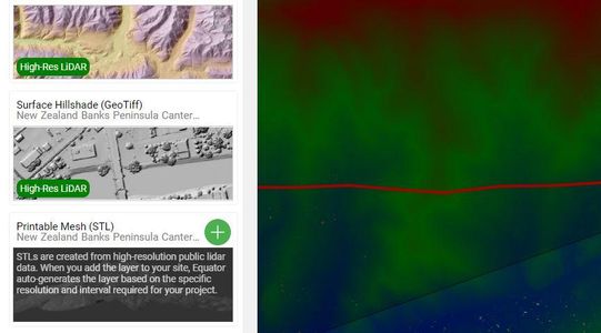

Step 5: Select the Printable Mesh Product
In the Data menu on the left, scroll down until you see “Printable Mesh (STL).” Click the green “+” button next to Printable Mesh (STL).

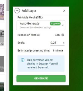

Step 6: Generate a 3D Printable Terrain File (STL)
Enter a scale factor of 0.1-2. Start with 1.0. You may need to experiment with different values here if your export has too tall of a base. Click “Generate” when you’re ready.
In this step, our goal is to only ensure that that the base of the model is the right thickness. In step 9, we discuss exaggerating the vertical scale of the terrain.
