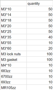

Additional purchased parts (can't 3D print)
- M3 screws(The screw length you need is in the picture above)
- M3 nuts
- M4*10 screws

- If you buy screws according to the picture above, the number of screws will exceed the actual number needed, but the number seems to be appropriate after considering repairs or other uses.
- Because my rc car design some of screws need to be cut before ㄓyou mount it.

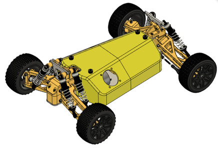

Step 1: How to Design RC Car
I used Fusion 360 to design my rc car. I divided rc car into three parts to design. First part is front wheel, second part is back wheel, third part is chassis. Because most of parts while used 3D printer to make, I try to decrease dangling area of the part to reduce support material. So all parts are very easy to 3d print .I attached full .step and .f3z in the end of the Instruction, if you want to change some design you can download all files and change whatever you want.

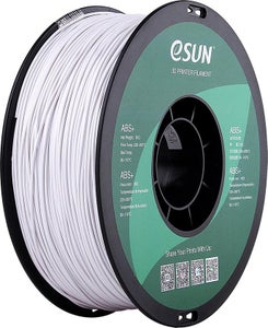

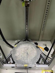

I used ABS filament to print all the components, because ABS plastic is a good material to resist impact. And this is also a common material for 3D printing.
There are some notes if you want to print ABS.
- Be careful when you print ABS because hot bed’s and nozzle’s temperature is very high, to prevent injury don’t touch the printer bed.
- ABS is very sensitive to environmental temperature change so if you can put your printers in closed environment.
- ABS is very easy to absorb water so when you don’t use abs filament put it in the dry box.
- To prevent warping you need to open Brim or Raft function and turn down fans when you print ABS
ABS print configuration
- Bed temperature: 100
- Nuzzle temperature: 245
- Nuzzle: 0.4mm
- Layer height: 0.2 mm
- Infill: 20%
- Wall thickness: 1.6mm

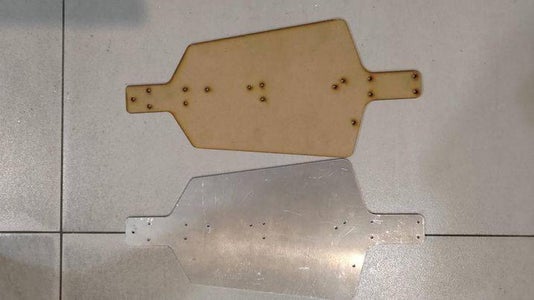

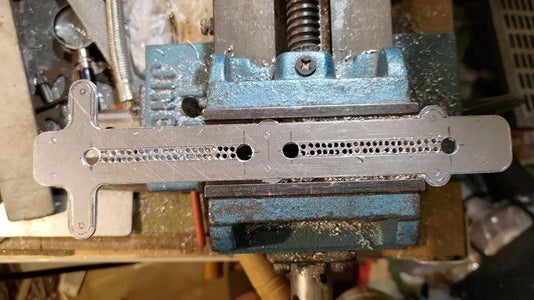

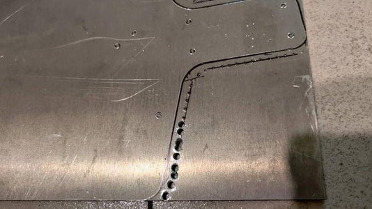

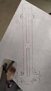

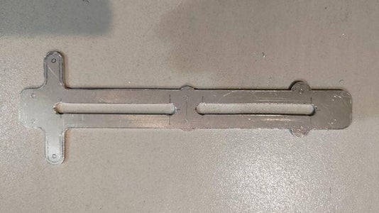

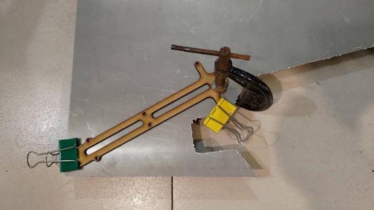

Step 3: Cut the 6061 Aluminum Alloy Board
To make the chassis we need to cut the 6061 aluminum board but I don't have expensive cnc machine or fiber laser cutting machine even worse I don't have wire saw machine that can cut alloy board so I choose alternative way to cut.
If you can use wire saw machine that will make you more easy deal with alloy board, if you can use cnc or fiber laser cutting machine congratulate you can just jump over this step because you just need to put .dxf file in the computer and get beautiful finished product.
If you like me have limited tools don't be sad because I will teach you how to cut the alloy board use drill. First you need to download chassis and second floor board .dxf files and print or laser cut them if you don't have laser cutting machine just use printer. After that fix the mold on the alloy board with your fixture and outline them, if you use paper just stick paper on alloy board.
Prepare the hammer, centerpunch and drill table now you can start second step. You need to draw offset line first, and offset distance depends on drill diameter, if your drill diameter is X mm you need to offset X/2+0.2 mm because you need some allowance which can be sanded off later Than you can take hammer and centerpunch to mark the drill location like pictures above.
Next you need to put alloy board on drilling machine and drill on the marks you make. After that you can easy use wire saw cut the board. And use rasp or grinder to remove extra material and burr, now you can start assemble.

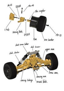

Step 4: Assemble Front Wheel Steering System
Before starting this step, you must first prepare the parts that will be used in this part.
3D printing parts
- left upper arm*1
- left lower arm*1
- right upper arm*1
- right lower arm*1
- left c-hub*1
- right c-hub*1
- steering block*2
- mount block*1
- shock tower holder*1
- steering arm*1 (include part1 and part2)
Laser cutting parts
- linkage block*1
Metal cutting parts
- shock tower*1
- HSP 106004 (Shock absorbers) *2
- 12mm hex wheel adapter *2
- Servo tie rod *1
- Tie rod *2
- Servo arm
- 683zz*2
- 693zz*2
Screws and Nuts
- M3*18
- M3*20
- M3*25
- M3*35
- M3*40
- M3 nuts
- M3 lock nuts
- M4*10
NOTE:
- When you assemble, you can open the design drawings attached below, so that you will know how to assemble.
- Some of screws may be too long to assemble so you need to cut to the right length.
- If you purchase the tie rod using the link I attached above, you may notice that it isn't long enough to mount. If you meet this situation you can lengthen the connecting rod using m3 fully threaded rods.
- If you find that some screw are hard to get through of hole you can use 3mm drill to clean the remainder in the hole.
- When you mount bearing you can use rubber hammer to hammer bearing to make interference fit. But don't use metal hammer to hammer bearing, you may broke bearing. And if you notice that you barely can't mount bearing, you can use heat air gun to uniform heating 3d printing part that will let you easy to mount. But be careful using heat air gun if you let 3D printing part overheat , you will let them deformation.
- If you want to screw don't overtight the screw, just use appropriate torque or you will broke 3d printing part.
- When designing this part, some parts inside have undergone some modifications, such as c-hub, so please use the latest version of stl files attached below when printing parts.
- In the latest version, I designed a bumper to protect the front wheel from impact, but the installation of the bumper must ensure that the screw length is long enough.
Front wheel steering system
Bumper

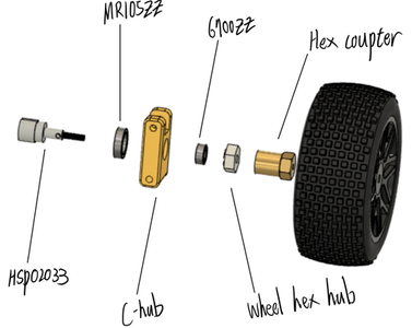

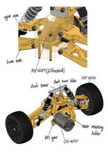

Step 5: Assemble Back Wheel Driving System
3D printing part
- left upper arm*1
- left lower arm*1
- right upper arm*1
- right lower arm*1
- Motor mounting holder*1
- c-hub*2
- shock tower holder block*1 (this part is for double shock absorber)
- shock tower block*4 (this part is for double shock absorber)
- differential up box*1
- differential down box*1
Laser cutting parts
- shock tower*1(this part is for double shock absorber)(You need to cut 5mm thick pmma board)
Metal cutting parts
- shock tower*1
- HSP 02024 (differential) *1
- HSP 106004 (Shock absorbers) *2 or *4
- HSP motor gear 0.6M 21T+64T *1
- HSP 06022 87mm (transmission shaft) *2
- HSP 02033 *2
- HSP 03015 bevel gear *1
- HSP 02100 12MMcombiner *2
- MR105ZZ
- 6700ZZ
Screws and Nuts
- M3*10
- M3*18
- M3*25
- M3*35
- M3*55
- M3*60
- M3 lock nuts
- M4*10
NOTE:
- Back wheel driving system have two different design. Type 1 mounted two shock absorber, Type 2 mounted four shock absorber. You can choose what kind of type you want. If you want to mount more hardware on rc car like raspberry pi, LIDAR you can choose type two.
- When you mount motor gear (21T) and big gear (64T) ensure the gap between two gear isn't too big or too small, if you gear gap is to small you will let motor overload and overheat even you will broke your motor and ESC and your battery will drain very fast. If your gear gap is to big, gear will be broken and can't output power correctly.
- Because motor gear and big gear expose outside you don't need to add lubricant between motor gear and big gear if you add lubricant you will let dust and little rock attach on gears.
- You need to add some lubricant in differential box that can protect damage between HSP 03015 bevel gear and differential and decrease annoy noise.
TYBE 1
TYBE 2
