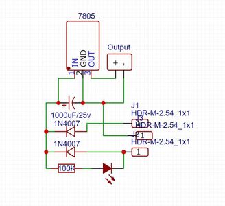

Step 5: Schematics and PCB Design
The schematics of PCBs can be seen above.
Step 6: Circuit Connection – Step 1
To make this 5v power supply circuit, we are using 1N 4007rectifier diode. We connect two rectifier diode cathode terminals with anode terminal of 1000µf/ 25v capacitor. For power indicator we are using 5mm LED light.
Now we connect 5mm LED cathode terminal with anode terminal of rectifier diode. Then we connect 1k resistor with anode terminal of LED and resistor’s other terminal with cathode terminal of that rectifier diode.
Step 7: Circuit Connection – Step 2
Though we are using 12.0.12 volt transformer, for that we need to connect a voltage regulating IC. Now we connect 7805 voltage regulating IC with the circuit. This voltage regulating IC have, three terminal. These three terminals have three different names (Voltage In, Ground and Voltage Out).
This time connect capacitor anode terminal with (Voltage In) terminal of voltage regulating IC and capacitor cathode terminal with (Ground) terminal of voltage regulating IC.
For voltage output, now we need to connect to cable with the circuit. We connect this cable anode terminal with (Output) terminal of voltage regulating IC and cathode terminal with (Ground) terminal of voltage regulating IC.
Step 8: Circuit Connection – Step 3
For input voltage we are using 12.0.12v transformer. We connect this transformer secondary section 12v cable with anode terminal of rectifier diode and transformer (Ground) cable with cathode terminal of voltage regulating IC. Then connect a AC cable primary section of transformer and connect AC cable with (220 ac) voltage.
