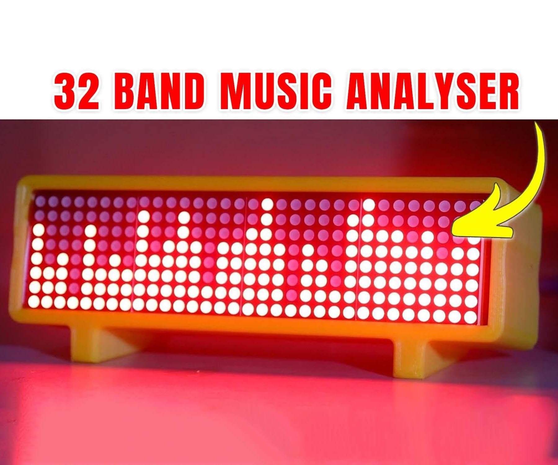

Step 6: Enclosure and Final Output
To give this project a clean and professional look, I designed and 3D printed a custom enclosure for the MAX7219 scrolling display. The enclosure not only protects the circuit but also makes the display look neat, attractive, and suitable for daily use. With the enclosure, this scrolling display becomes perfect for placing on an office desk, study table, shop counter, or any indoor location.
This is the final result of the project, and it looks much more polished and professional.
