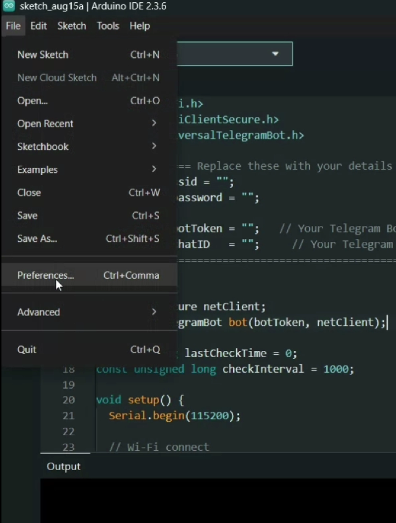

For Arduino IDE Setup Follow these steps:
  1. Open Arduino IDE on your computer.
  2. Go to File > Preferences.
  3. In the Additional Board Manager URLs field, paste this link:
https://raw.githubusercontent.com/espressif/arduino-esp32/gh-pages/package_esp32_index.json
  1. Then click OK.
