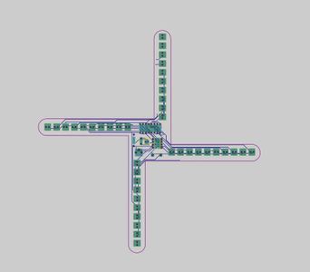

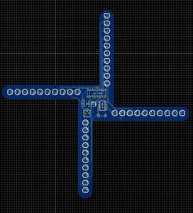

Step 5: Schematics and PCB Design
The schematics of PCBs can be seen above.
Step 6: Hardware of Flip-flop Project Circuit
To make this adjustable led flasher circuit, we might need some electronics component. JLCPCB has its own parts library. JLCPCB has 200k+ in stock components, 24 hours rapid SMT assembly.
You can check SMT parts library here - https://jlcpcb.com/parts
