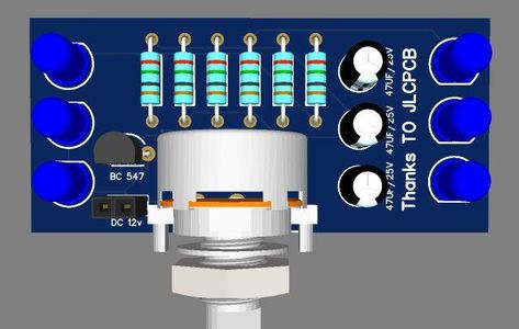

Step 6: Circuit Connection – Step 1
To make this circuit, we are using 6 pieces led light. 1st we divide this led light by 2, than each side there will be 3 pieces led light. Now we make a series connection in these 3 pieces led light.
Now we connect 1 side led light negative leg with emitter leg of transistor. Then we make a series connection between 4.7KΩ resistor. At this time, we connect this two resistor with positive leg of two side LED light. Then connect, 4.7KΩ resistor series point with “Collector” leg of transistor.
Step 7: Circuit Connection – Step 2
Again we need to make a series connection, between 2.2 KΩ resistor and 1 MΩ resistor. Then connect one side of 2.2 KΩ resistor with Collector leg of transistor resistor and 1 MΩ with Base of transistor.
Now we connect, resistor series section with negative leg of other side led light.
Step 8: Circuit Connection – Step 3
This time, we need to make series connection with these 3 capacitors. That means, we connect one capacitor negative leg with other capacitor positive leg, and this method continue for all capacitors.
For this way, from here we will get two terminal. One is positive and the other one is negative. We connect capacitor positive terminal with Collector leg of transistor and connect negative leg with Base leg of transistor.
Step 9: Circuit Connection – Step 4
This time, we connect led positive leg with DC-12v power supply and connect DC 12-v negative cable with Emitter leg of transistor.
To adjust volume, now we need to connect a potentiometer with the circuit. We connect potentiometer input cable with 220 Ω resistor and the resistor other terminal with positive and negative terminal of capacitor.
Then we connect, potentiometer output leg with Emitter leg of transistor.
Step 10: Circuit Connection – Step 5
Now we just need to connect a 1KΩ resistor with the circuit. We connect this resistor with DC-12v negative leg and other terminal with capacitor positive and negative leg.
Our circuit is now completely ready for use. Just plug-in power, rotate potentiometer smoothly and enjoy the circuit.
