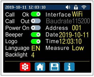

 To enter the system settings menu, we need to press Shift + Menu buttons. In this menu, several settings are made, such as Wi-Fi connection, language, logo display, beeper, backlight, as well as time settings.

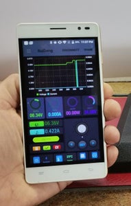

 A very useful and interesting feature of this model is that it can be controlled through an application on a Smartphone or PC. The PC application in particular is very useful and contains many functions, including updating the device's firmware. I think the most important feature is a constant current setting that will surely save you a lot of electronic components and devices.
