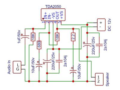

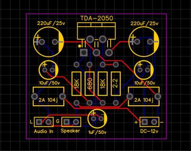

Step 5: Schematics and PCB Design
The schematics of PCBs can be seen above.

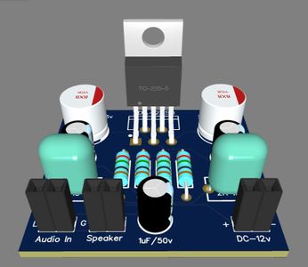

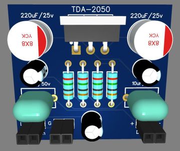

Step 6: Hardware of This Amplifier Circuit
To make this amplifier circuit, we might need some electronics component. JLCPCB has its own parts library. JLCPCB has 200k+ in stock components, 24 hours rapid SMT assembly.

Step 7: Connect Resistor With the Circuit
To make this mono amplifier circuit, 1st we connect resistor with the circuit. We connect 18 KΩ resistor with 1 no leg of this sound IC. Then connect 680 Ω resistor with 2 no of this sound IC and again 18 KΩ resistor with 4no leg of sound IC and it’s other terminal with 2no leg of Sound IC.
We also connect 2.2 Ω resistor with 4 no leg of sound IC. Our all resistor connection is complete.
Step 8: Connect Capacitor With the Circuit
Now we connect 1µf / 50v capacitor positive leg with 1no leg of sound IC. Then connect 10µf / 50v capacitor positive leg with 680 Ω resistor and another 10µf / 50v capacitor positive leg with 2.2 Ω resistor.
We connect one piece polyester film capacitor with 200µf / 25v capacitor. Then connect it’s negative terminal with 3no leg of sound IC.
Again we connect another polyester film capacitor with 220µf / 25v capacitor. Then connect it’s positive terminal with 5no leg of sound IC.
Step 9: Connect Audio Input Cable
The 18 KΩ resistor was connected with 1no leg of sound IC, we connect it’s other terminal with 10µf / 50v capacitor negative leg and 220µf / 25v capacitor positive leg.
Now we need to connect Audio Input cable with the circuit. Connect audio input “L” cable with 1µf / 50v capacitor negative leg and audio input “G” cable with 10µf / 50v capacitor negative leg.
Step 10: Connect Power Supply and Speaker
For output sound, we need to connect a sound speaker. Connect sound speaker one terminal with 4no leg of sound IC and it’s other terminal with audio input “G” cable.
To operate this amplifier circuit, now we need to connect power source with the amplifier circuit. For power source, we are using DC 12v. We connect it’s positive cable with 5no leg of sound IC and it’s negative cable with 3no leg of sound IC.
Step 11: Soldering & Cleaning Amplifier Circuit
It’s the time to soldering and cut-off all extra leg of electronics component. Now we solder all component leg carefully and to make sure we need to check all of them for several times. We also remember that, there should not be any kind of short circuit connection. For perfect inquiry, we should use liquid PCB cleaner to wash PCBs.
Thanks to JLCPCB for sponsor us such a quality PCB board.
Step 12: Enjoy Sound
Our circuit is completely ready for use. To protect overheating, we need to use heat sink with the sound IC. Just plug-in power and enjoy the effect of sound.
