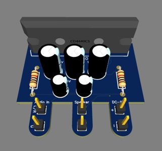

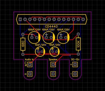

The Design of amplifier circuit along with the PCB layout can be seen above. Power supply don’t included with the circuit. You can use any 12 batteries or 12v power adaptor for this project.

Step 6: Connect 10µf/25v Capacitor With CD-4440 IC
To make this circuit, 1st we connect some common connection in this 14 legs of sound IC. We connect 3, 6, 8 and 14 no leg of this sound IC.
Then connect 10µf/25v capacitor positive leg with 1no leg of sound IC and connect another 10µf/25v capacitor positive leg with 7no leg of sound IC.
Now connect this two capacitors empty terminal with each other.
Step 7: Connect Resistor With Circuit
We are using two resistors to make this circuit. One is 680 Ω and the other one is 100 KΩ.
This time, we connect 680 Ω resistor with 3no leg of sound IC and it's other terminal with 10µf/25v capacitor negative leg.
Now connect 100 KΩ resistors with 2no leg of sound IC.
Step 8: Connect 100µf/25v Capacitor With Circuit
We are using 3 pieces 100µf/ 25v capacitor. We connect 1st piece capacitor negative terminal with 3no leg of sound IC and it's positive terminal with 5no leg of sound IC.
Then we connect 2nd piece capacitor negative leg with 12no leg of sound IC and it's positive terminal with 13no leg of sound IC.
This time we connect 3rd piece capacitor positive leg with 9no leg of sound IC and it's negative terminal with 10no leg of sound IC.
Step 9: Connect Audio Input Cable With Circuit
There are two cables of an audio input cable. One is called Ground cable and the other one is called Left/Right cable.
Now we connect Ground cable with 14no leg of sound IC and connect Left/ Right cable with empty terminal of 100 KΩ resistors.
Step 10: Connect Speaker Cable With Circuit
For output signal, now we need to connect a sound speaker with the circuit. We connect sound speaker one terminal with 10no leg of sound IC and another terminal with 12no leg of sound IC.
Step 11: Connect Power Source With Circuit
For power source, we are using DC-12v power supply adaptor. To make this circuit, you also can use a 12v battery as a power source. Now connect DC-12v positive terminal with 11no leg of sound IC and negative terminal with 14no of sound IC.

Step 13: Final Action
Our circuit, is now completely ready for use. Now just plug-in the audio source with amplifier circuit and enjoy the surrounding sound effect of this amplifier circuit
