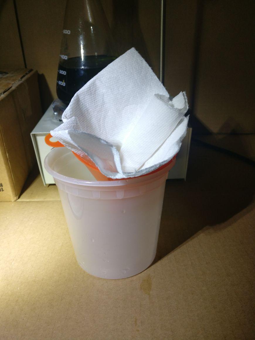

It may take a few hours to a few days, depending on if the flask was heated, but eventually the iron should entirely dissolve, or there will appear to be no bubbling but there is still iron metal. If there is a large amount of iron remaining, try adding more acid, as a large amount may have vaporized and left the flask leaving less to react. If there is no immediate reaction, try heating up the solution. If you have noticed that the flask has cooled down and a green crystalline solid has formed, that is a good sign. It means the reaction has nearly or fully completed and you can move to the next step. Filter the solution through the funnel into a second container and add the filtrate back into the flask. If all the iron is gone, add a few grams more in large pieces, as you will still need some metallic iron for the next step.
