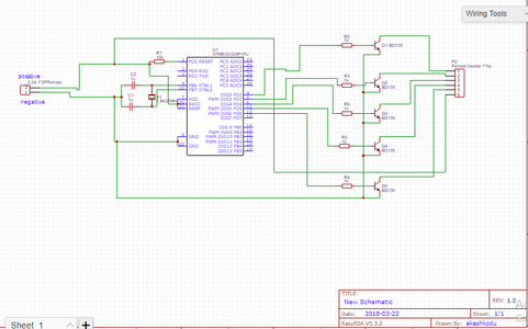

Step 1: Design& Order the Pcb
In this project I make the pcb using easyeda tool.....
& order the pcb on jlcpcb.com

Arduino circuit-https://drive.google.com/file/d/0B6lRKp5uKbSbY2JmVFhVU19RZVE/view

Here I use 5 channel.....but you can use upto 12 channel according to your requirement.....
Components list......
1. Leds
2. 22pf capacitor*2
3. arduino uno
4. 5v power supply...you can use your mobile charger
5. wires for led soldering
6. bd139 transistor*5...you can use any npn transistor
7. 16mhz crystal
8. vero board for name making
9. 1k resistor*5
10. 10k resistor
11. 28 pin ic base (optional)
