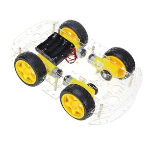

  • Smart Car Chassis 4WD

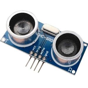

  • Ultrasonic sensor (HC- SR04)

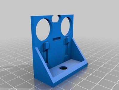

  • Ultrasonic sensor (HC- SR04) bracket servo mounted - 3DPrinted part Download here
    If you do not have a bracket you can find some other way to attach the sensor to the servo motor, perhaps some glue,etc

  • Connect Ultrasonic module pin (VCC) to Arduino pin [+5V]
  • Connect Ultrasonic module pin (GND) to Arduino pin [GND]
  • Connect Ultrasonic module pin (ECHO) to Arduino pin digital (4)
  • Connect Ultrasonic module pin (TRIG) to Arduino pin digital (3)

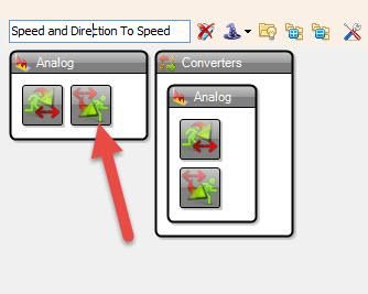

  • Add 2X "Speed and Direction To Speed" component

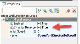

  • Select "SpeedAndDirectionToSpeed1" and in the Properties window set "Initial Reverse" to True
This will reverse the Start Direction, Depending on your motor wiring, you can leave this to False

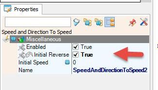

  • Select "SpeedAndDirectionToSpeed2" and in the Properties window set "Initial Reverse" to True"
