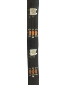

  • 5V WS2811 LED strip (64 LEDs)
Leds on that strip are individually addressable so you can lit any led you want in any color that you want.

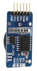

  • DS3231 RTC module
This is RTC module that connects to Arduino via I2C bus. It is more reliable then any other RTC modules that I worked with like DS1302. It also has a built in temperature sensor

The led strip I would use is 5v WS2811 led strip . I cut it into strips containg 8 leds each. Then I solder them together to form eight by eight matrix.

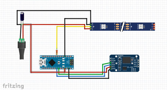

Time to connect it to Arduino.
  • LED strip GND and 5V to Arduino GND and 5V
  • LED singnal goes via 200Ohm resistor to Arduino Pin 5.
I am powering the strip from Arduino as I would be Lighting just individual LEDs so 0,5Amp that Arduino can provide would be sufficient.
You can write a simple code to test if all leds work fine and also test the colors I will use in the final project.
#include <FastLED.h>#define LED_PIN     5#define NUM_LEDS    64#define BRIGHTNESS  140#define LED_TYPE    WS2811#define COLOR_ORDER GRBCRGB leds[NUM_LEDS];CRGB Colors [13]{CRGB::Gray,CRGB::Orange,CRGB::Maroon,CRGB::Red,CRGB::Cyan,CRGB::Lime,CRGB::Green,CRGB::Purple,                     CRGB::Yellow,CRGB::White,CRGB::Blue};void setup() {    delay( 3000 ); // power-up safety delay    FastLED.addLeds<LED_TYPE, LED_PIN, COLOR_ORDER>(leds, NUM_LEDS).setCorrection( TypicalLEDStrip );    FastLED.setBrightness(  BRIGHTNESS );    }void loop(){for (int j=0;j<13;j++)    for (int i=0;i<65;i++){    leds[i]=  Colors[j];    FastLED.show();    delay(50);    leds[i]=CHSV( 0 , 0, 0);    FastLED.show();  }}<br>
Step 10: Connecting All Components
It is time to connect all components
  • Lets start with connecting Arduino 5V to LED 5V and RTC module VCC pin.
  • Then we connect all the grounds.
  • Next we connect led strip signal pin to Arduino digital pin 5 through 220Ohm resistor
  • The RTC module I am using is DS3231 which is the I2C device so we connect Clock pin to Analog Pin A5 and Data pin to analog pin A4.
