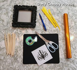

Step 1: Gather Your Supplies
You probably have a lot of these supplies lying around already, but you'll likely need to purchase a roll of copper, embossing tools, and liver of sulfur to complete this project.

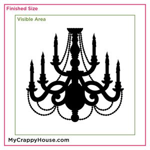

Step 2: Pick an Image to Make Into Art
Choose your design. I used this chandelier icon to make my art, but you can really use anything at all. If you're stuck for ideas, check out dingbat fonts, which are comprised of images rather than letters.*
(If you're up for the challenge, I've included my chandelier design for download. It might be smarter to start with something less complex, but I always like to jump into the deep end when learning new things. Maybe you do too...)
Now choose a frame for your finished art. Measure the frame opening for the visible area and scale your chosen design accordingly. I used a 4 inch frame (with a 3.5 inch opening), but you can pick any size you like.
* Regarding letters... You can totally make a word into art, but make sure you print it backwards, or your word will be backwards in your finished art. In fact, any design will be backwards, so if the orientation matters to you, print your design backwards. Mine is symmetrical, so I didn't have to worry about this issue.

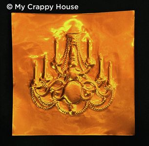

Step 4: Emboss

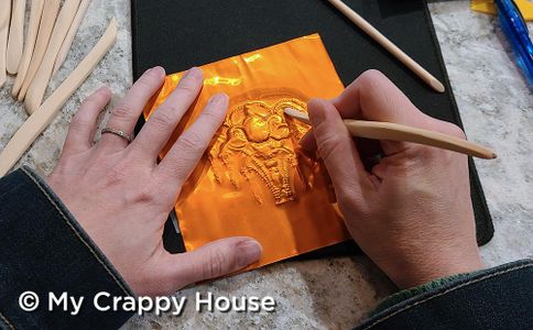

Now you'll use your embossing tools to press your design into the copper. (Note: I bought both wooden and plastic embossing tools, but I preferred the wooden ones.)
You can remove your paper design at this point, but don't just pull the tape off! Use your junky scissors and cut right through the paper and copper so that your art is sized correctly. (Note: You can totally leave your paper design attached and emboss through it if you want to.)
Press from the back on the spots that you want to pop out on the front. Then, flip your work over and press on the spots that you want to recede.
Keep embossing and flipping until you like what you see. If you haven't removed your paper yet, use your junky scissors now to cut through the paper and copper at the same time to cut it down to actual size.

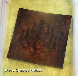

Step 5: Blacken the Copper
Follow the directions on the liver of sulfur to make a bath for your piece, using a shallow plastic or glass container that will allow your art to be completely submerged.

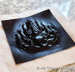

Drop your piece in and wait for the science to happen! It'll take a few minutes, but be patient. The copper will eventually turn black. When this happens, remove it and rinse it under the faucet.
Allow it to dry completely on a paper towel. Try to handle it by the edges to avoid touching the surface of your piece.
Step 6: Wipe Off the Black
Once your piece is COMPLETELY DRY, you can begin to wipe off the black with a dry paper towel. Take your time with this. You'll want to leave some black in the nooks and crannies to enhance your art, so work slowly in small sections.

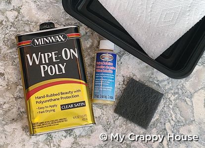

You can switch to your scouring pad when you've done all you can with the paper towel. Don't over scrub! Let the black stay in the crevices to make your art really pop.
Step 7: Wipe on the Poly
Pour some of the Wipe On Poly onto a paper towel and rub it over the surface of your piece. Let that dry completely before handling it again.

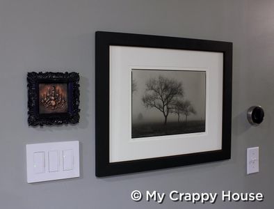

Step 8: Frame Your Piece

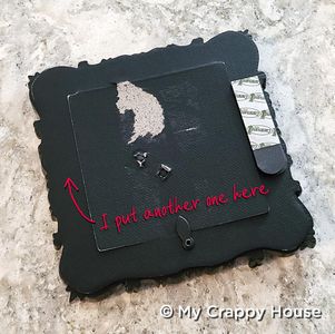

I used a table top frame for my piece, but I wanted to hang it on the wall. To do so, I ripped off the frame's kickstand and added Command picture hanging strips to the back. I chose black strips to blend in with my black frame and you can't see them at all when the piece is hanging up.
Step 9: Hang Your Art

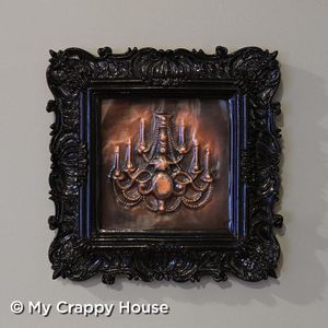

The last step is to hang and admire your finished art. Then just let the compliments roll in...
