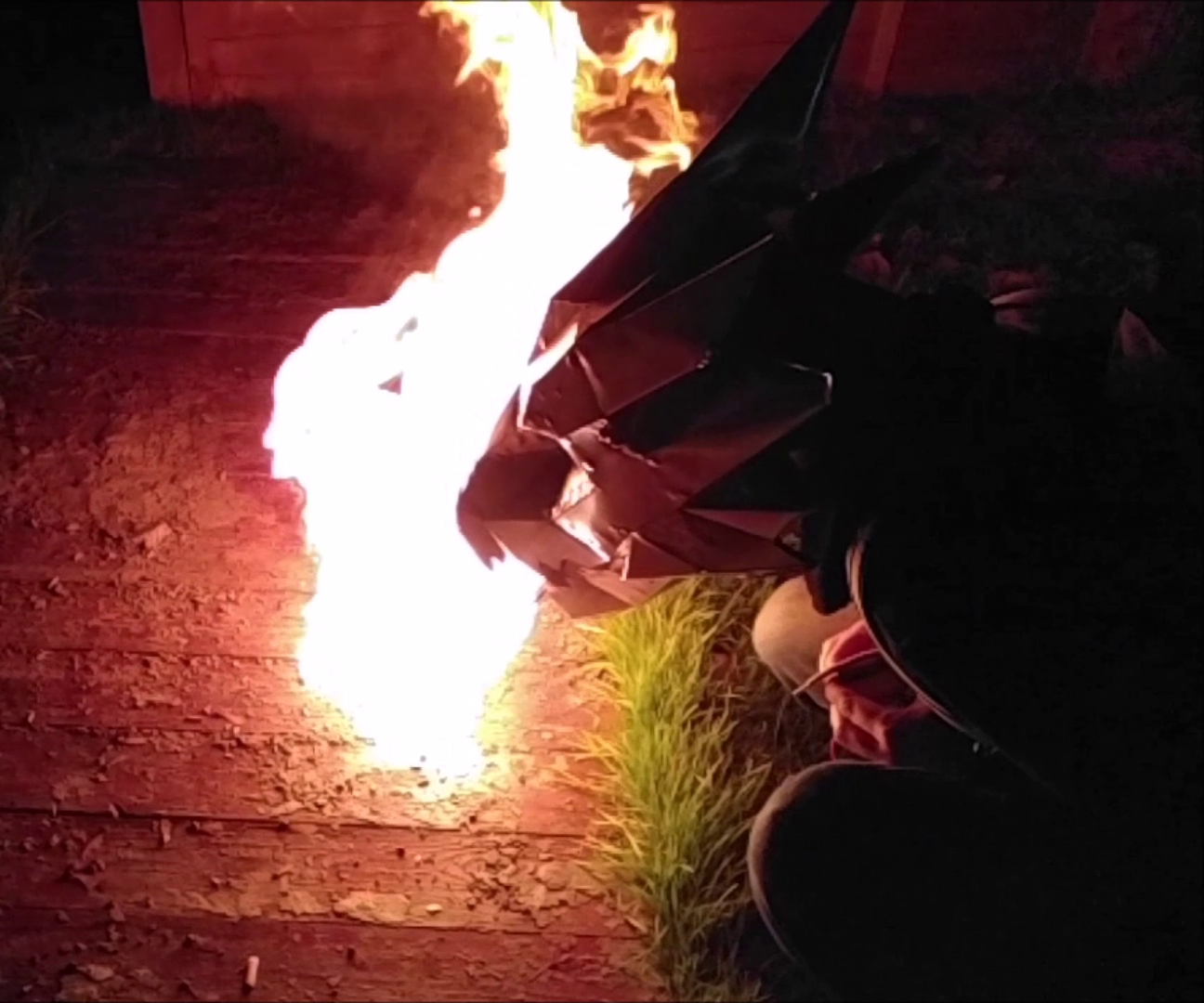

Introduction: How to Make Blue Flames
I wanted to make Red, Blue, and Green flames for my fire breathing dragon mask. This is how I did the Blue.

First mix the Copper sulphate and Hydrochloric acid until it's dissolved, then add that to the methanol. you want a solid >70% methanol to ensure flammability.
Step 3: Test It Out
Burn it, just do it in a well ventilated space. Don't breath in the fumes. Wear PPE as necessary. Follow the MSDS for the chemicals you buy.
- You can burn it in an empty can.
- Or use a spray bottle to spray it.
- Or even use a fuel injector off a car, though this will break it in my experience.
