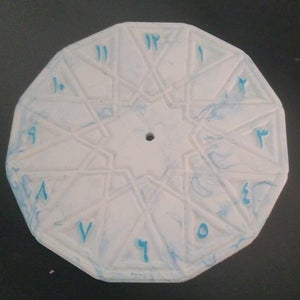

Depending on the finish you want you could leave the clock unpainted, color parts of it in with a marking pen or paint the whole clock. With the gold clock I spray painted it and then colored the black parts in with a marking pen.
With the blue one I added some blue tempera powder in before casting to give a marble effect and I then colored in the letters with a blue color pen (sharpie)
