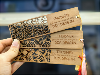

Cherry wood bookmarks are a beautiful and practical piece of stationery. As a natural material, cherry wood is free of harmful chemicals and suitable for readers of all ages. Its natural wood grain and warm tones make it the perfect accessory for any book or notebook.
Now is going to use a Thunder Laser system to make laser cherry wood bookmarks. Let’s start to explore fun with the laser!
Material: 3mm cherry wood
Laser head: 2" head
Laser engraving machine: Thunder Bolt Pro32 55watt

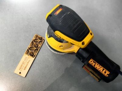

Step 3: Polish Them:
We can use a polisher or sandpaper to polish the cherry wood bookmarks for removeing greasy and dirty. That's because water will make cherry wood warp immediately. So don't wet your cherry wood bookmarks. Let’s do it by yourself!
