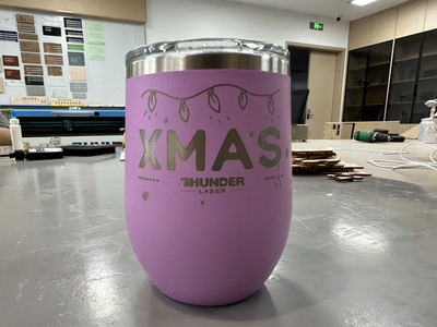

The Christmas Thermal Cup is a stylish and practical choice for celebrating the festive. Made from durable, insulated stainless steel, it will keep your drinks at the ideal temperature for a long time on Christmas Day!
It's a good idea to prepare a surprise for Christmas in advance. So now is going to use a Thunder Laser system to decorate the Christmas Thermal Cup. Let’s start to explore fun with the laser!
Material: coated thermal Cup

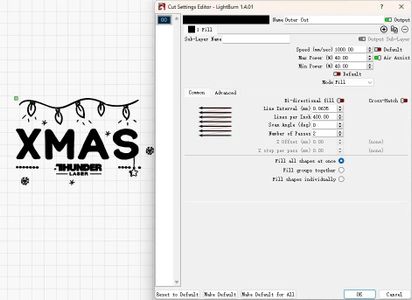

Step 1: Setting Parameters
Processing Mode:
Engraving speed: 1000mm/s
Engraving power: 40%
DPI: 400
Passes: 2
You can also draw on CorelDraw and then click on the laser plug-in to switch to the laser software. Set the appropriate parameters on the laser software and click Download to transfer the design to your laser engraving machine.

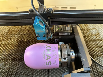

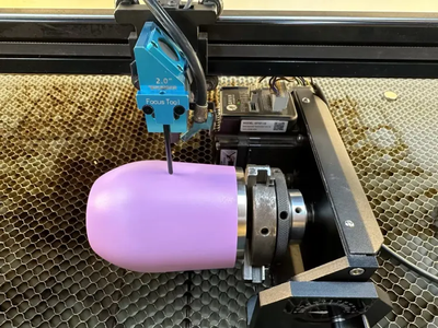

Clamp the cup on the laser rotary attachment that is put with the package, move the laser head to the highest point of the cup and adjust the focus to avoid sensor collision. You can use auto and manual focus. Press “Origin” on the LCD control panel to set the starting position, then press “Start” to begin working.
