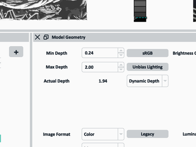

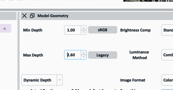

One thing I did right away in Hueforge was increase the Min Depth and Max Depth to 1mm and 2.6mm. I did this so that the base color would be at the minimum, 1mm thick and by default it would only be .24mm which is just too thin for a coaster and if only only increase the max depth, you'll just get thicker details which won't help the stability of the coaster.
Then I played around with the colors until I liked how they were distributed on the image.
